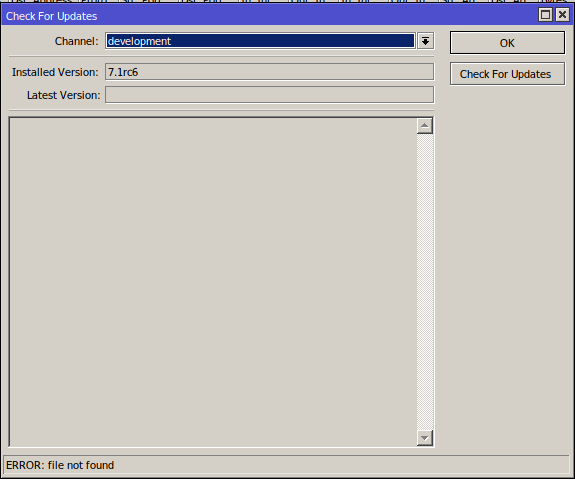

Upgraded an RB5009 and a chateau LTE 12 and getting ERROR: file not found on the package screen after rebooting.
Still no changelog shown in System → Packages for v7…

Changelog and future upgrade channels are now fixed.
