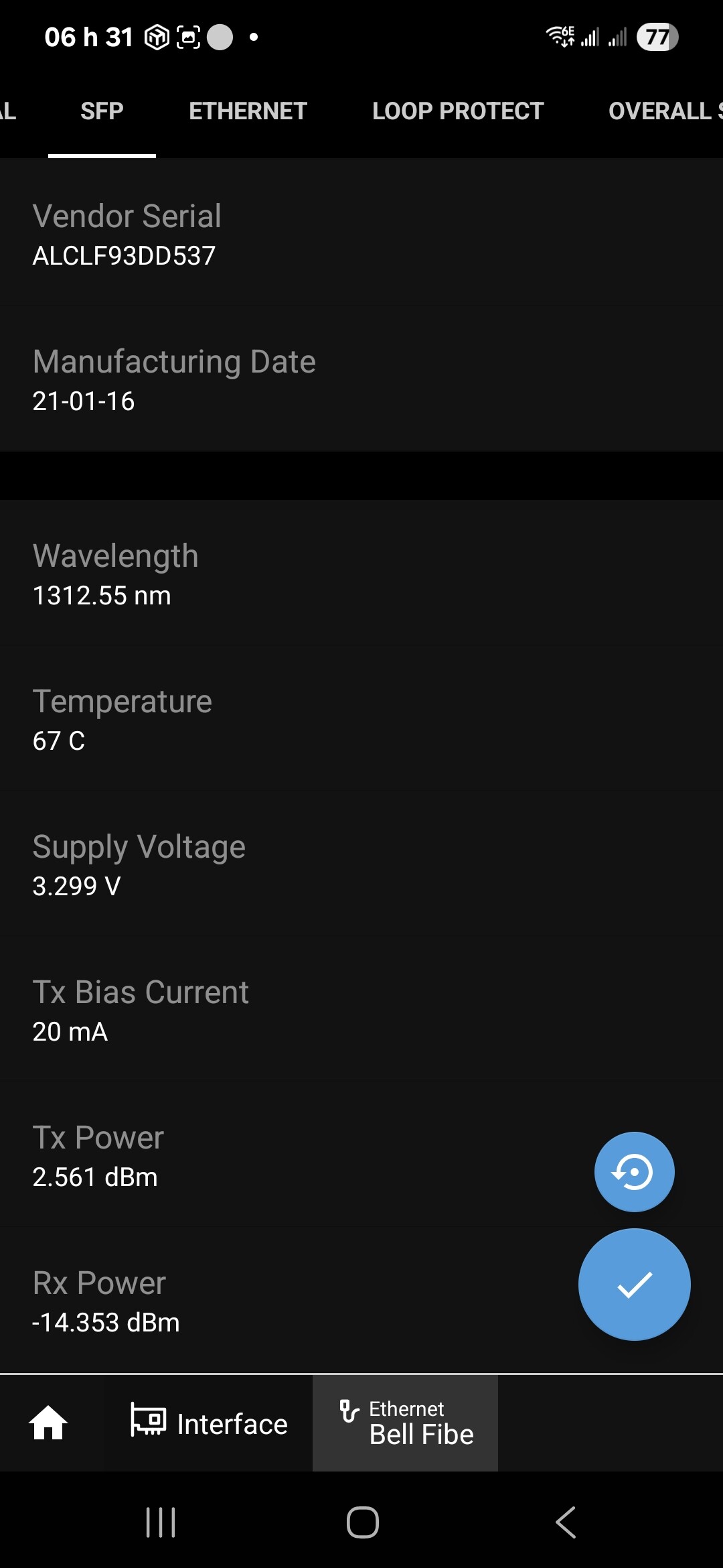

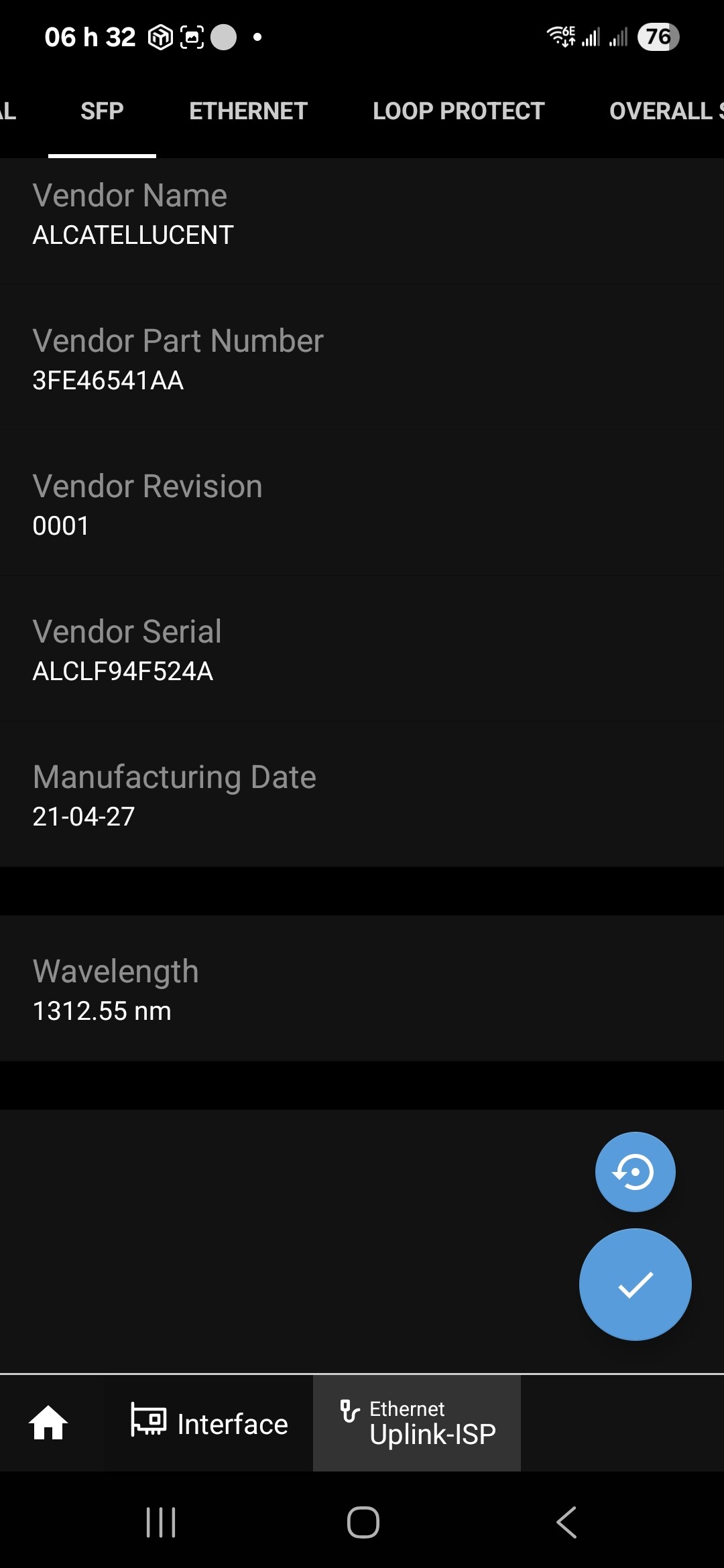

*) sfp - improved system stability with some GPON modules for CCR2004 and CCR2116 devices;
Could you look also to unblocked the GPON reading? Like rx and tx power?
