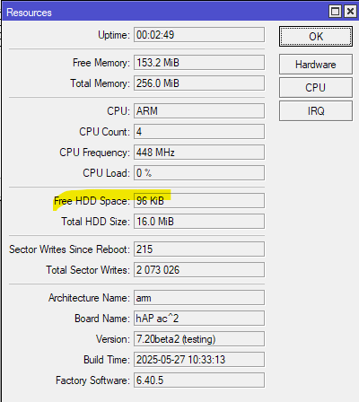

Additional evergreen (beside of memory leak), ROM space shortage on 16MB hAP ac^2 with wifi-qcom-ac. It is quite obvious - RouterOS 7.20 for ARM is roughly 100kB bigger than RouterOS 7.19. Netinstall procedure has been applied with manual configuration.

FWIW, most early beta’s are generally bigger than the final stable package. Still a lot of 16MB flash units in production, so problem is not limited to hAPac2 (which is a great router, albeit dated)
