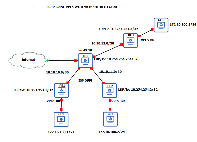

This is the the basic topology i’m working on, If the route reflector is v6 it’s working properly as expected but if I change the route reflector to any v7 it won’t work VPLS is up (using BGP Signal VPLS) everything is up mpls forwarding table is ok, but both CE1 and CE2 can’t reach on Layer3.
But normal VPLS is working on either v6 or v7 route reflector
V6 RR + V7 PE + BGP Signal VPLS is working
V7 RR + v7 PE + BGP Singal VPLS is not working
V7 RR + v7 PE + VPLS is working

This is a well known problem, from a year or more. The only workaround is a full BGP mash, as you tryed. Be carefull also with CCR2216, if any, when using MPLS/LDP. When running, packet loss is introduced on forwarding plane.
Really? do you guys reported it and what does support say is that architecture specific?

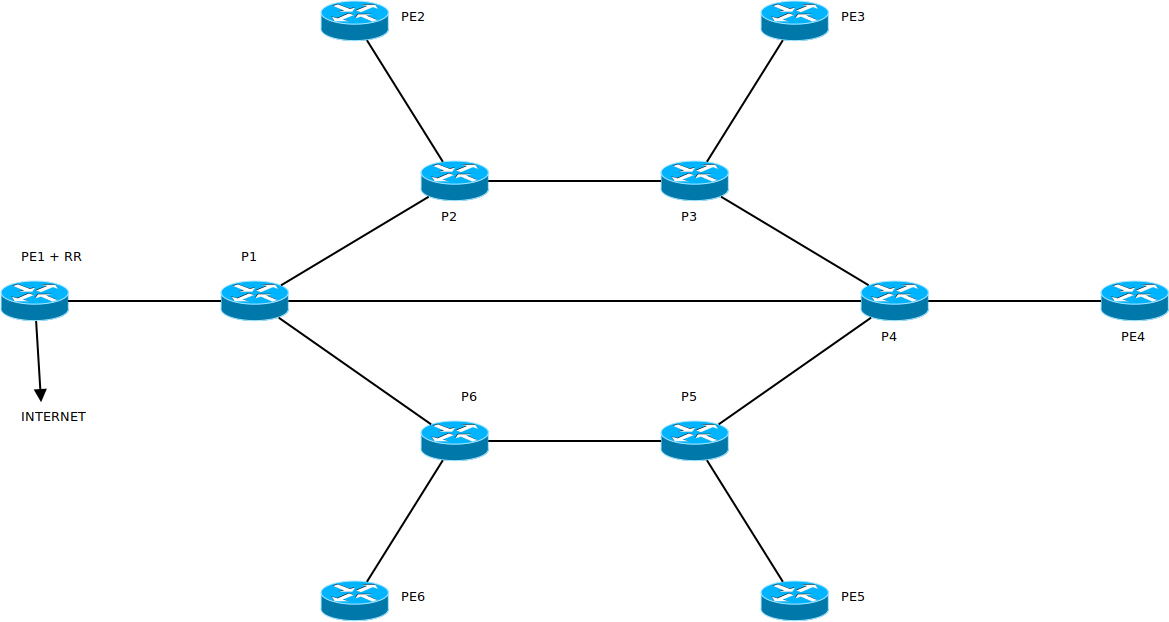

I use this topology to test things, the inner ring is P only, those routers runs only OSPF + MPLS, on PE routers, the PE routers runs iBGP too, PE1 is RR, other PEs are RR-client.
I configured L2VPN + L3VPN. The BGP L[23]VPN config from PE1:

VPLS_B interfaces are up and running, but VPLS_A IFs aren’t:
[admin@rtr1.PE] > /interface/vpls/print
Flags: R - RUNNING; D - DYNAMIC
Columns: NAME, PEER, BGP-VPLS
#    NAME   PEER        BGP-VPLS
0 RD vpls1  10.0.10.13  VPLS_B
1 RD vpls2  10.0.10.15  VPLS_B
2 RD vpls3  10.0.10.12  VPLS_B
3 RD vpls4  10.0.10.14  VPLS_B
4 RD vpls5  10.0.10.16  VPLS_B
[admin@rtr1.PE] >
I can ping all other PE IP’s (IPv4 and IPv6) over VPLS_B. Configs almost identical, except loopback IPs, router-id and VPLS site-id. We have another project, where we using LDP signaled VPLS with eBGP and cisco on the other side, and its works fine with minimal config:

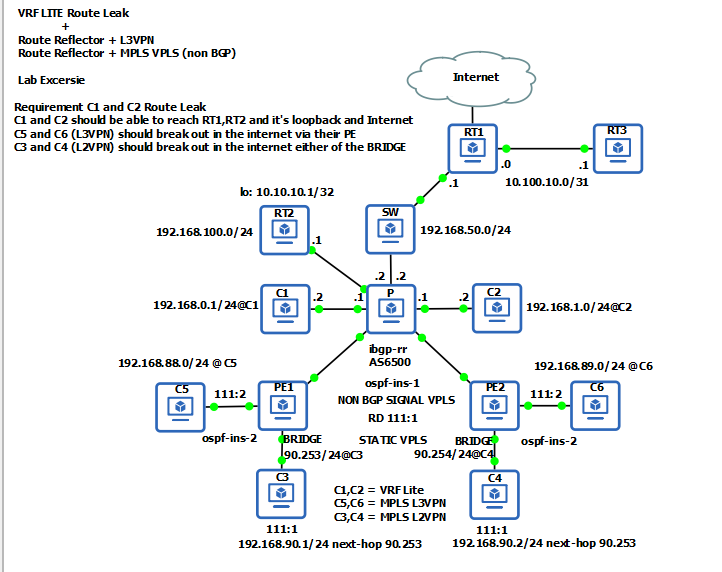

I have another example all router is v7 but the VPLS this time is static non BGP signal in all of my example P is route reflector and LDP only and I don’t use cisco style id
for the “P” it’s role is ibgp-rr and all PE is ibgp
# P Router
/mpls ldp
add disabled=no lsr-id=10.254.254.1 transport-addresses=10.254.254.1
/mpls ldp advertise-filter
add advertise=yes disabled=yes prefix=10.254.254.0/29
add advertise=no disabled=yes prefix=0.0.0.0/0
/mpls ldp interface
add disabled=no interface=ether5
add disabled=no interface=ether6
/routing bgp connection
add afi=ip,l2vpn,vpnv4 as=65000 disabled=no local.address=10.254.254.1 .role=ibgp-rr name=TO-PE1 nexthop-choice=\
    force-self output.default-originate=always remote.address=10.254.254.2/32 router-id=10.254.254.1 routing-table=main \
    templates=default
add afi=ip,l2vpn,vpnv4 as=65000 disabled=no local.address=10.254.254.1 .role=ibgp-rr name=TO-PE2 nexthop-choice=\
    force-self output.default-originate=always remote.address=10.254.254.3/32 router-id=10.254.254.1 routing-table=main \
    templates=default
/routing ospf interface-template
add area=backbone disabled=no interfaces=lo passive
add area=backbone dead-interval=15s disabled=no hello-interval=5s interfaces=ether5
add area=backbone dead-interval=15s disabled=no hello-interval=5s interfaces=ether6
# PE1 Router
/routing bgp template
set default afi=ip,l2vpn,vpnv4 as=65000 disabled=no router-id=10.254.254.2 routing-table=main
/routing ospf instance
add disabled=no mpls-te-address=10.254.254.2 mpls-te-area=0.0.0.0 name=ospf-instance-1
add disabled=no name=ospf-instance-2 originate-default=never router-id=C5 vrf=C5
/routing ospf area
add disabled=no instance=ospf-instance-1 name=backbone
add disabled=no instance=ospf-instance-2 name=custC
/interface vpls
add arp=enabled bridge=BRIDGE disabled=no mac-address=02:CB:FE:DA:C2:88 mtu=1500 name=TO-P peer=10.254.254.1 \
    pw-control-word=default pw-l2mtu=1550 pw-type=vpls vpls-id=111:1
/mpls ldp
add lsr-id=10.254.254.2 transport-addresses=10.254.254.2
add advertise=yes disabled=yes prefix=10.252.254.0/29
/mpls ldp interface
add interface=ether5
add afi=ip,l2vpn,vpnv4 as=65000 disabled=no local.address=10.254.254.2 .role=ibgp name=TO-P remote.address=\
    10.254.254.1/32 router-id=10.254.254.2 routing-table=main templates=default
/routing bgp vpn
add disabled=no export.redistribute=connected,ospf .route-targets=111:2 import.route-targets=111:2 .router-id=C5 \
    label-allocation-policy=per-vrf name=bgp-mpls-vpn-1 route-distinguisher=111:2 vrf=C5
add area=backbone dead-interval=15s disabled=no hello-interval=5s interfaces=lo passive
add area=custC dead-interval=15s disabled=no hello-interval=5s interfaces=ether1
