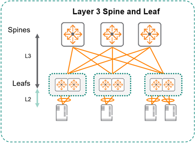

Did you test VXLAN fabric in real Spine&Leaf topology? Where Spine only interconnect Leaves and VTEPs only configured on Leaves?
I’m only curious if it works.
This topology works in my testing but not in the real hardware for now, as soon as v7.20 become stable i’m going to try this in real world with real hardware, this is working fine in GNS3
