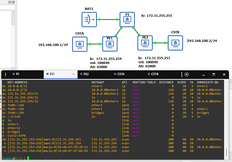

Great your lab works OOB in GNS3 will going to lab it on real hardware this week and see if this will fly thanks a ton
/routing/route/print where afi=“evpn” yields no result this is clearly a bug
[admin@PE1] > /routing/route/print
Flags: U - UNREACHABLE, A - ACTIVE; c - CONNECT, b - BGP, o - OSPF, e - EVPN
Columns: DST-ADDRESS, GATEWAY, AFI, ROUTING-TABLE, DISTANCE, SCOPE, TARGET-SCOPE, IMMEDIATE-GW
   DST-ADDRESS                                    GATEWAY          AFI   ROUTING-TABLE  DISTANCE  SCOPE  TA  IMMEDIATE-GW
Ac 10.0.0.0/31                                    ether1           ip    main                  0     10   5  ether1
Ao 10.0.0.2/31                                    10.0.0.0%ether1  ip    main                110     20  10  10.0.0.0%ethe>
Ao 172.31.255.253/32                              10.0.0.0%ether1  ip    main                110     20  10  10.0.0.0%ethe>
Ac 172.31.255.254/32                              lo               ip    main                  0     10   5  lo
Ao 172.31.255.255/32                              10.0.0.0%ether1  ip    main                110     20  10  10.0.0.0%ethe>
Uc fe80::/64                                      ether2           ipv6  main                  0     10   5
Ac fe80::/64                                      ether1           ipv6  main                  0     10   5  ether1
Ac fe80::/64                                      bridge1          ipv6  main                  0     10   5  bridge1
Ac ::1/128                                        lo               ipv6  main                  0     10   5  lo
A  lo                                                              link  main                  0
A  ether1                                                          link  main                  0
A  ether12                                                         link  main                  0
A  bridge1                                                         link  main                  0
A  Cust2-EVPN                                                      link  main                  0
Ab [172.31.255.253:256]imet:0|172.31.255.253      172.31.255.253   evpn                      200     40  30  10.0.0.0%ethe>
 e [172.31.255.254:256]imet:0|172.31.255.254      172.31.255.254   evpn                      200     40  10
Ab [172.31.255.253:256]macip:0|56:AD:63:7D:2D:1C  172.31.255.253   evpn                      200     40  30  10.0.0.0%ethe>
 e [172.31.255.254:256]macip:0|7A:6D:6F:5F:D6:B3  172.31.255.254   evpn                      200     40  10
[admin@PE1] > /routing/route/print where afi="ip"
Flags: A - ACTIVE; c - CONNECT, o - OSPF
   DST-ADDRESS        GATEWAY          AFI  ROUTING-TABLE  DISTANCE  SCOPE  TARGET-SCOPE  IMMEDIATE-GW
Ao 10.0.0.2/31        10.0.0.0%ether1  ip   main                110     20            10  10.0.0.0%ether1
Ao 172.31.255.253/32  10.0.0.0%ether1  ip   main                110     20            10  10.0.0.0%ether1
Ao 172.31.255.255/32  10.0.0.0%ether1  ip   main                110     20            10  10.0.0.0%ether1
[admin@PE1] > /routing/route/print where afi="evpn"
[admin@PE1] >
