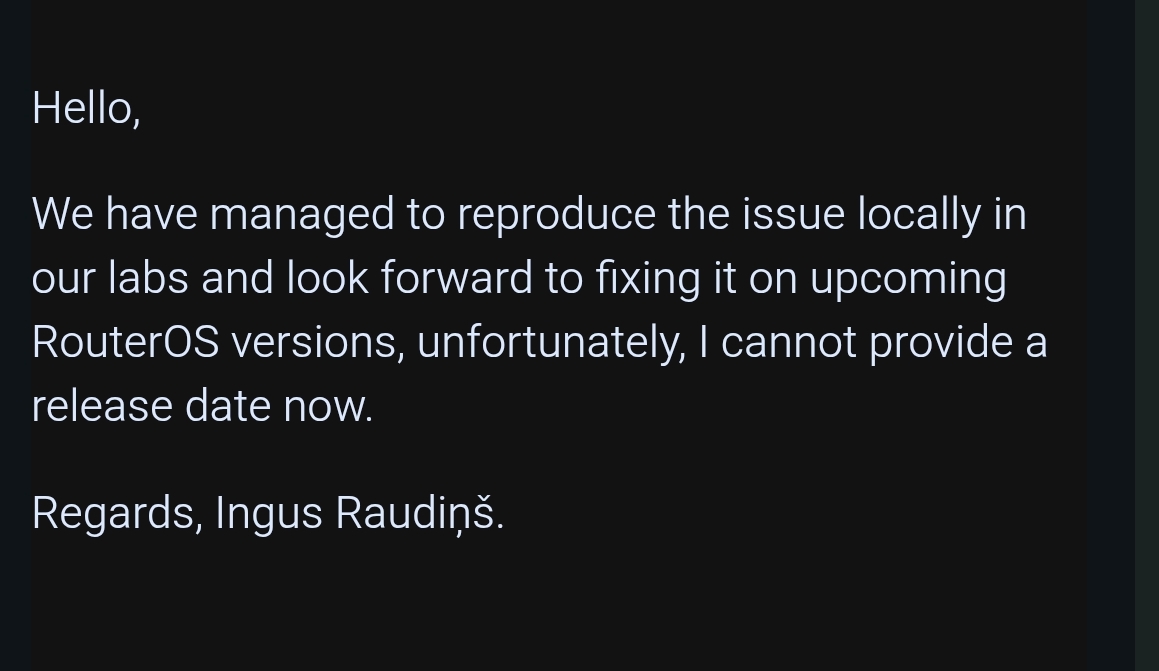

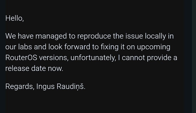

Please contact MikroTik Support regarding the CRS354-48P-4S+2Q+ controller error:
https://mikrotik.com/support
[SUP-209240]
