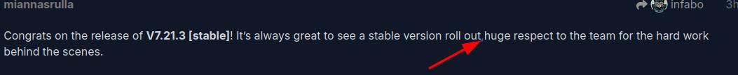

Probably spamming other forums… who would create a new account just to “congratulate on a new release”…? No, this account was created to spam the forum later, either by editing the post or exploiting the fact that existing users can post without pre-approval.
Not probably, in fact 100% spam. Look closely. The one comma is linked.....

That wasn't there when I first approved that post (and flagged the user for personal tracking because I was already suspecting something like this to happen).
Alas ... he's gone to Walhalla now ...
