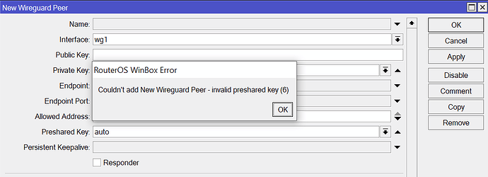

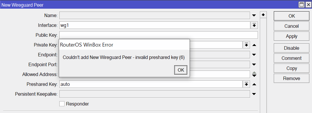

Does not generate wg preshared key - auto
