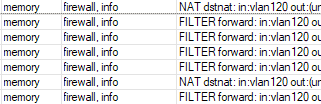

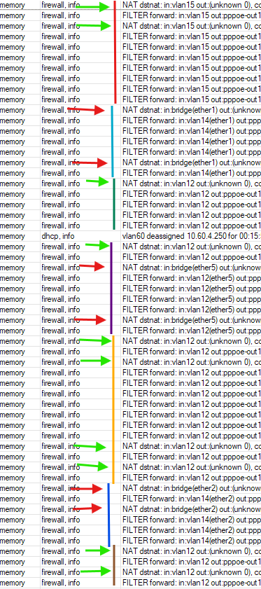

About the issue of DSTNAT rule failing to match on my RB5009 that i mentioned in the post above: V7.21rc [testing] is released! - #17 by CGGXANNX
I did further testing on the RB5009 with 7.21rc1 and there seems to be a bug with the in-interface assignment in the dstnat chain for connections coming from an untagged VLAN of a bridge port:
I've added two rules to dstnat and filter that log TCP connections with destination port 855
add action=accept chain=dstnat dst-port=855 log=yes log-prefix=NAT protocol=tcp
add action=accept chain=forward dst-port=855 log=yes log-prefix=FILTER protocol=tcp
Here are the log results with connection attempts from several VLANs and ports of the RB5009:
When the connection is coming from a tagged VLAN of an ethernet port, in the DSTNAT chain the in-interface is correctly identified. In the screenshots they are marked by the green arrows. In the filter table, chain forward, the in-interface is also correct.
However, if the VLAN is an untagged VLAN of the port, in the DSTNAT chain the in-interface is incorrectly assigned as bridge (with information about the port), as you can see pointed by the red arrows. When the packet reaches the forward chain of the filter table, however, the in-interface becomes the correct one (but it has the bridge port information attached).
I've tested with access ports and hybrid ports (ether1, ether2, ether5 in the screenshot). If the VLAN is tagged, then the interface is correct in the DSTNAT chain, but if it's untagged, then it's identified as bridge, which is incorrect and was the reason why my DSTNAT rules could not match (because they have checks on in-interface-list/in-interface). In the screenshot you can see for example that vlan12 can be correctly detected or not based on whether it's untagged on the port or not (it's tagged ether1 and ether2 and untagged on ether5).
The bridge has Bridge VLAN Filtering with L2 hardware offload on all bridge ports active (H flag).
Test on a spare RB750Gr3, also with Bridge VLAN Filtering and hardware offload, doesn't show the issue!
Have modifications been made to the VLAN handling for the RB5009? The problem did not exists on versions <= 7.20.5.

The issues encountered are:
  • DSTNAT rules see wrong in-interface when the connection is from untagged VLAN.
  • Fasttrack ineffective, counters don't increment although connections have F flag (symptoms like last year when I had DHCP snooping enabled on bridge and you've explained to me that it disabled FastPath).
Do you have an option to disable the container package, reboot and see if this fixes the problem?
I've to go out soon so will not be able to redo the upgrade and disable the container package right now. But now that you mention it, previously when I that the real dstnat rules (not debugging rules) with logging turned on and reboot, it does appear that the rules get hits correctly until the log lines from the containers starting up appeared.
Also, maybe the fasttrack thing is related to that too. Like I mentioned in the previous posts, fasttrack does work for a short moment after reboot, with the counters counting a few tens of KiB, then stopped. Maybe they stopped after the containers have started, but I can only verify this in a few hours.
The same behavior is reproduced in our labs, it is somehow container related. We will look for solution. Thanks for the report! :+1:
