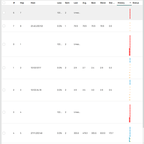

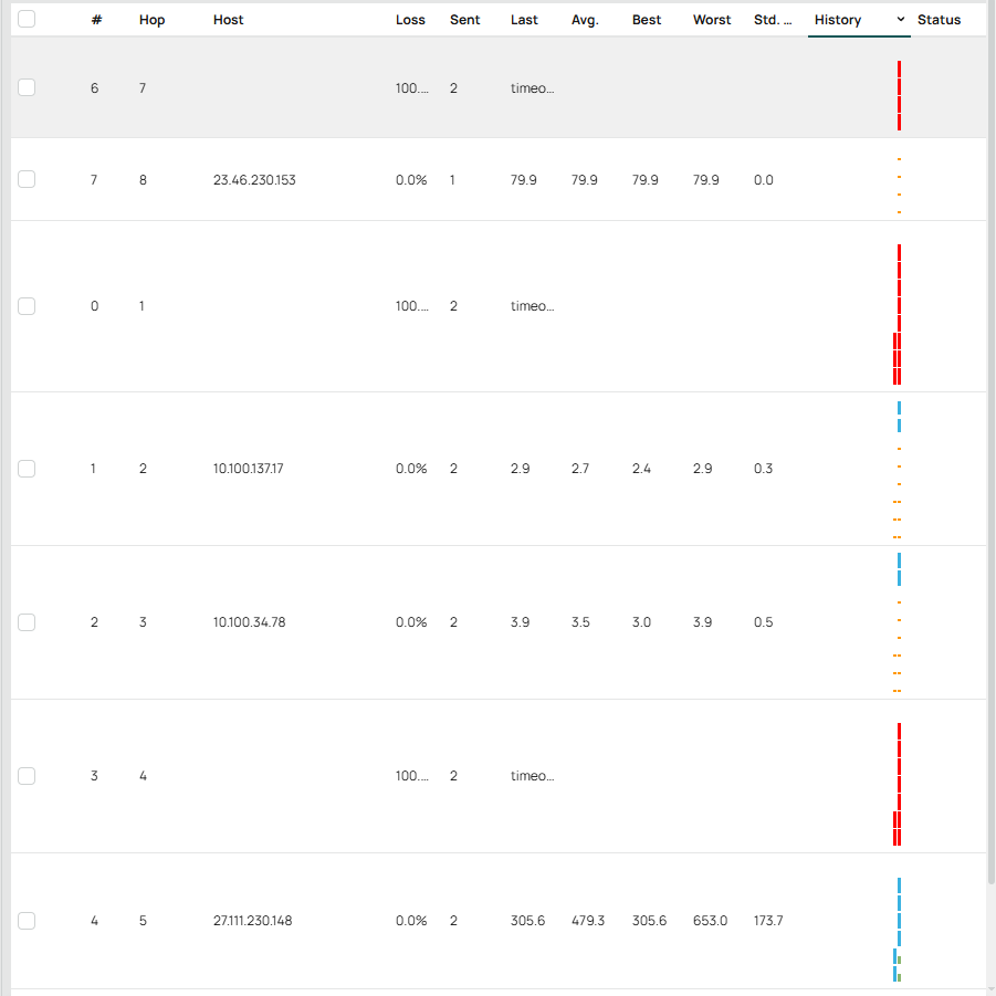

Hello, I encountered the following issue after installing 7.22
Device: Mikrotik Hex
Issue: Traceroute tool on web, history column bars are now expanding vertically instead of horizontal, causing the results to expand endlessly, screenshot attached for reference.
