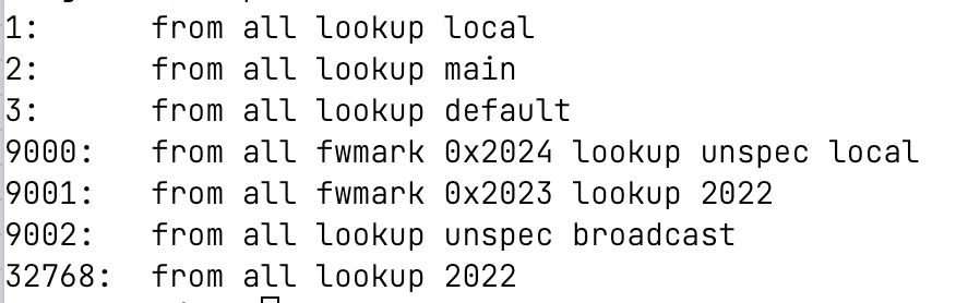

After upgrading to 7.22, the IP rule table in the container has a priority issue, which was normal in version 7.21.

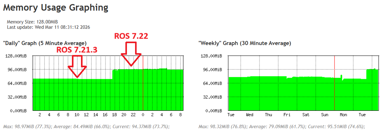

After the update I see a lot more RAM used, I don't know if this is normal...

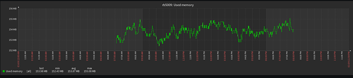

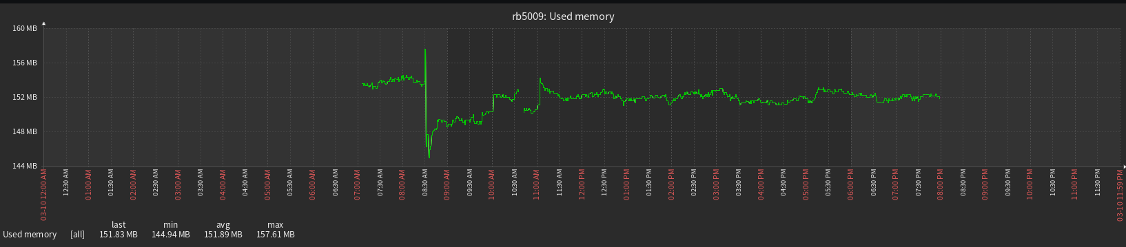

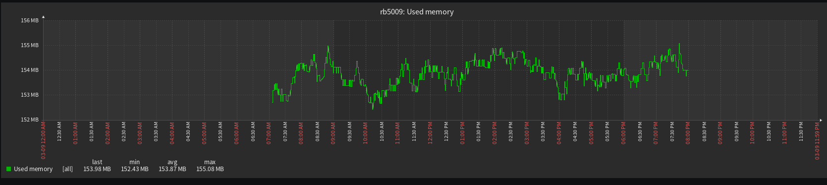

Hello. I see quite the opposite in a RB5009
This is yesterday. I've updated 8.35 AM aprox.
and this is the day before yesterday

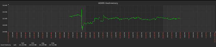

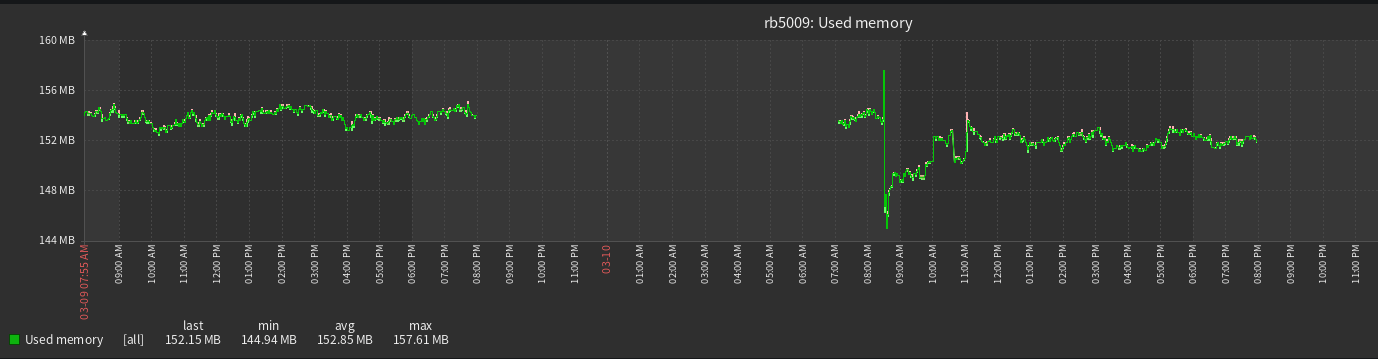

Last two days
Zabbix server is down from 8:00PM to 7AM.
