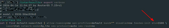

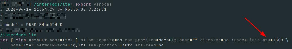

Noticed a config change caused by simply upgrading from 7.22.1 to 7.23rc1.
I had mtu=auto before the upgrade. It was removed.
I also checked "export verbose" to make sure. I thought, maybe mtu=auto is the new default? But it was not.
There are two changelog items regarding lte mtu:
The fix was to remove my mtu=auto?
