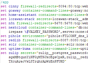

On a router where the /app feature has never been used (and will never be used), after an upgrade from 7.22.1 to 7.23rc1, the following appears in the /export
Which pollutes the export output and introduces irrelevant changes to my configurations under source control.

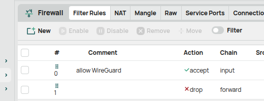

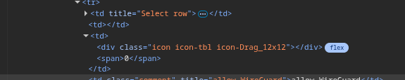

Is the WebFig firewall filter rule number now being below the rule handle some new feature designed to make the list even less compact???
It appears that that div is now marked as “flex” when it wasn’t in 7.22.1.

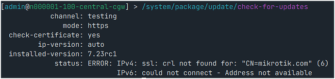

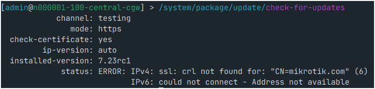

This persists since the first 7.23 beta on my CCR2004. Setting check-certificate=no fixes it, but it is a workaround, not a proper fix.
