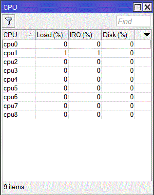

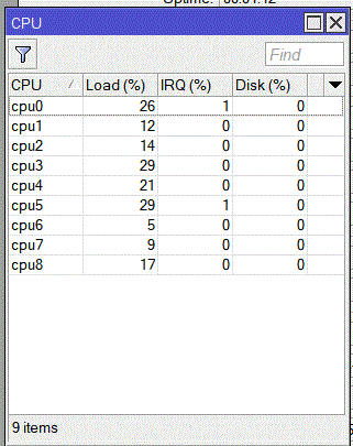

MY CPU has gone nuts comparatively speaking … as shown in the below graphic …
running 7.1.1 Stable my CPU normally is stable around 1% … the above is put WAY out of wack ???
Reverted back to 7.1.1 and CPU is back to normal operation … WoW :smiley:
