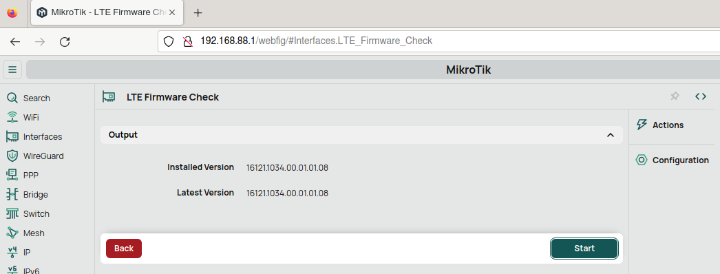

Is your modem firmware up to date?
/interface/lte/firmware-upgrade lte1
Yes, it’s already uptodate.

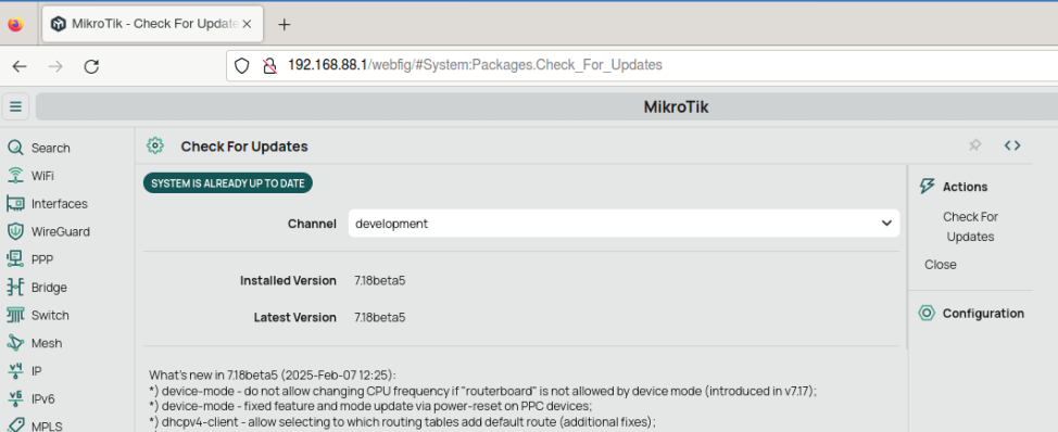

I now have even switched to the development version of RouterOS,
and after that had also to install a newer “LTE Firmware” version,
but LTE speed continues to be very bad :frowning:
