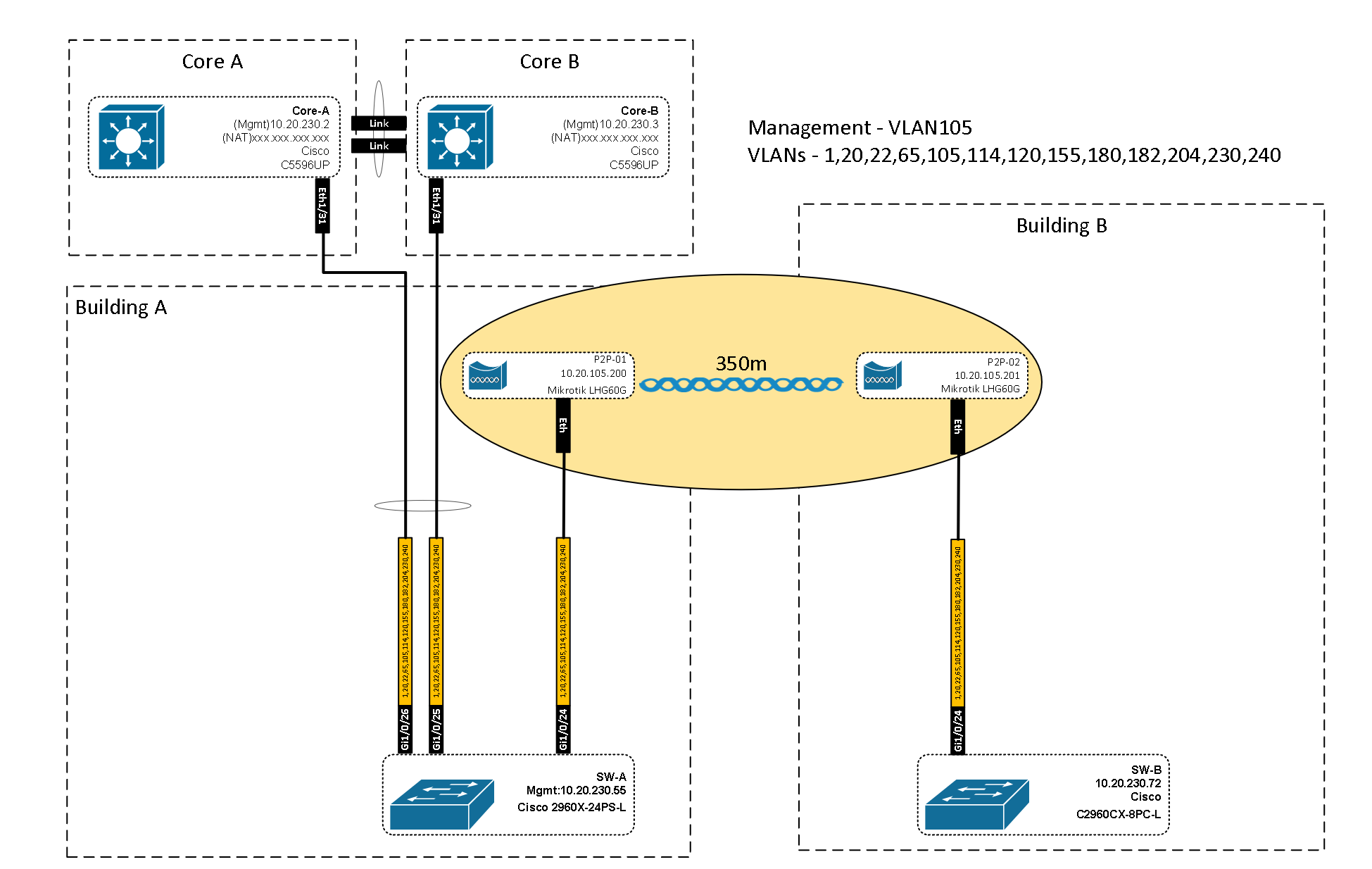

What I am trying to do is create the below topology:
Basically I wish to trunk all of the VLANs from SW-A over to SW-B. VLAN105 is the MGMT VLAN which will be used to access the bridge and station-bridge devices only. VLAN1 is to be kept native.
The issue I saw in regards to MAC flapping with my config was that mac addresses were seen flapping between po1(Gi1/0/25-26) on SW-A and on Gi1/0/24, how this was happening is what I was trying to understand as these mac addresses are elsewhere on the network and should not be seen from Gi1/0/24 (Bridge).
I did find a config example of someone who I believe has similar issues with trunking (not sure about mac flapping though as he didn’t have vlan-filtering on), so I was going to give it a go. It would be great to see a good example of configs that achieves this, it will make me understand more of what’s going on and how this is supposed to work.

The topology diagram has indeed added a lot of missing parts to the puzzle, but on the other hand it is now even harder to understand why MAC addresses should be flapping due to anything but a bug on the Mikrotik side as there is no way to create an L2 loop physically. The only thing to come to my mind would be that Mikrotik’s flavor of RSTP (which is used on the bridges by default, and you haven’t set protocol-mode to none in your early attempts) would somehow interfere with STP operation of the Cisco switches - not that it would be clear to me how that would be possible.
