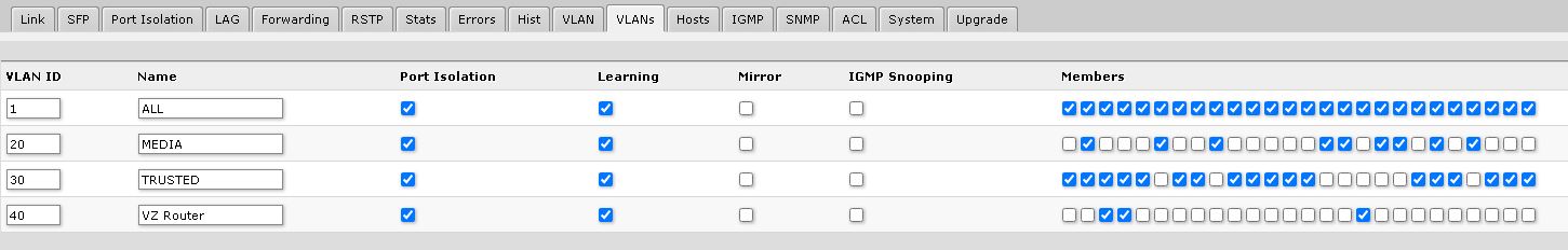

  2. I’m totally stuck on setting up my VLANs.
I would like 3 VLANS: TRUSTED, MEDIA, G3100
I’ve attached a screenshot of the VLANs tab (I would have attached the config – see my question #1).
Here’s an example of where I’m failing:
On the VLAN tab, I’ve tried setting the Default VLAN ID for port 17 to 40. When I do that, I lose connected to it from port 3 (which is in VLAN 40, but with Default VLAN 1). Connectivity from 3 to 17 is lost regardless of the VLAN MODE. If I change port 3 to have a Default VLAN of 40, connectivity is restored (but I lose connectivity to all the other ports).
What am I doing wrong?

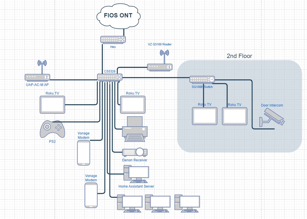

Below is a rudimentary network drawing.
FIOS comes into the Hex (which is the main router).
Port 4 of the CSS326 is connected (wired) to the Hex
The old FIOS router (G3100) is connected to port 17 of the CSS326
Various other devices are connected to other ports on the CSS326.
The system seems to be working fine without port isolation or VLANS, but, as the tinkerer I am (and suspect most people on this forum are), I would like to be able to make it better and learn cool stuff along the way.
My thinking is that the G3100 needs Inet access to provide the cable set top boxes with channel data, so let’s isolate the G3100 from everything else on my LAN. That’s how I come to VLANS. I understand that this might be better achieved through port isolation, but then I wouldn’t have successfully set up a VLAN.
One I have the VLAN capability, I could set up another VLAN for MEDIA-type devices (TVs, Roku boxes, receiver, etc.). Then another the Home Assistant server. Etc.
Does my thinking make sense?

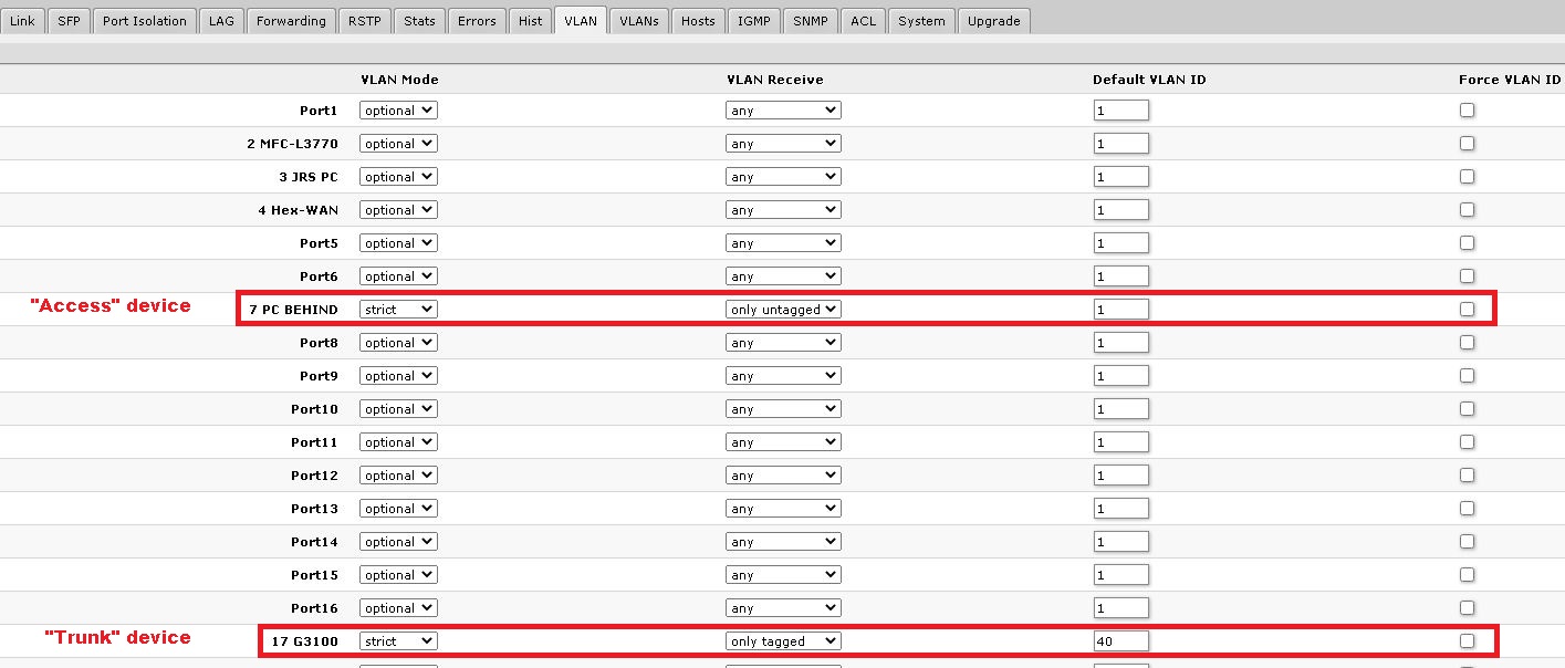

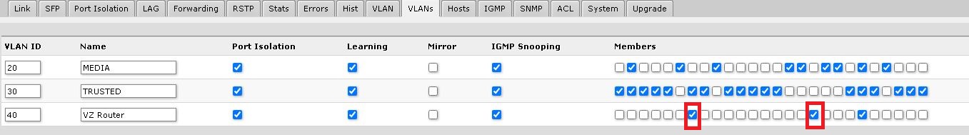

I watched the new videos and tried to recreate what was done.
Simple: 2 devices – ports 7 and 17 on the switch.
Port 7 is Windows PC. Set up as access port: Strict mode, Only Untagged, Default VLAN ID 1
Port 17 is the old VZ G3100 router. Set up as a trunk port: Strict mode, Only Tagged, Default VLAN ID 40
Windows PC cannot ping G3100.
Attached are screen shots.
What did I do wrong?
You are all hosed up. Thank you for posting both screen captures.
You said that you believe the G3100 is NOT a VLAN aware device (makes sense), but you have the port set to only VLAN tagged.
Your non-VLAN aware Windows PC is set to Only untagged (as it should be) with a default VLAN ID of 1, but on the VLANs tab it is on VLANs 30 and 40.
If a port is untagged only, the Default VLAN ID on the VLAN tab and the assigned VLANs on the VLANs tab should match. And there should ONLY be one VLAN selected for that port on the VLANs tab. On the VLAN tab, you CAN leave untagged only ports to VLAN Mode = Optional, but once you have things working you might want to change them to Strict.
All of your other various devices (presumed to be non-VLAN aware) should have the Default VLAN set to either 20 or 30 on the VLAN tab - depending on which VLAN they are set to on the VLANs tab.
You have port 4 listed as Hex-WAN. I assume that really is a LAN port on the Hex, not the WAN port. The WAN presumably will connect to the ONT.
The Hex will need to become VLAN aware and the connection between the Hex and the CSS will be a trunk port. The other possibility is to set each port in the Hex as a different VLAN and run separate non-tagged cables for each VLAN from the Hex to the CSS - but that only works if the Hex and switch are close to each other, and limits you to just a few LANs.
For now, I would also uncheck Port Isolation and IGMP Snooping on all VLANs on the VLANs tab. Leave them off until you really understand what they do.
Assuming for the moment that you will have a single VLAN tagged connection between the Hex and the CSS, and likely the only other connection on the Hex being the WAN to the ONT, you will be operating VERY similar to the way I am. I can help you with the Hex VLAN setup as well. If you on the other hand have other devices on these same VLANs plugged directly into the Hex, you will need to configure a Bridge in the Hex and I can not help you with that. My mode is that the router exclusively operates as a router and ALL switch functions take place in the switch. From your drawing, that is also what you will be doing.
BTW, until you know what you are doing, don’t limit yourself on access to the switch on the System tab. If you don’t understand what you are doing, limiting access on the System tab can result in locking yourself out of the switch.
