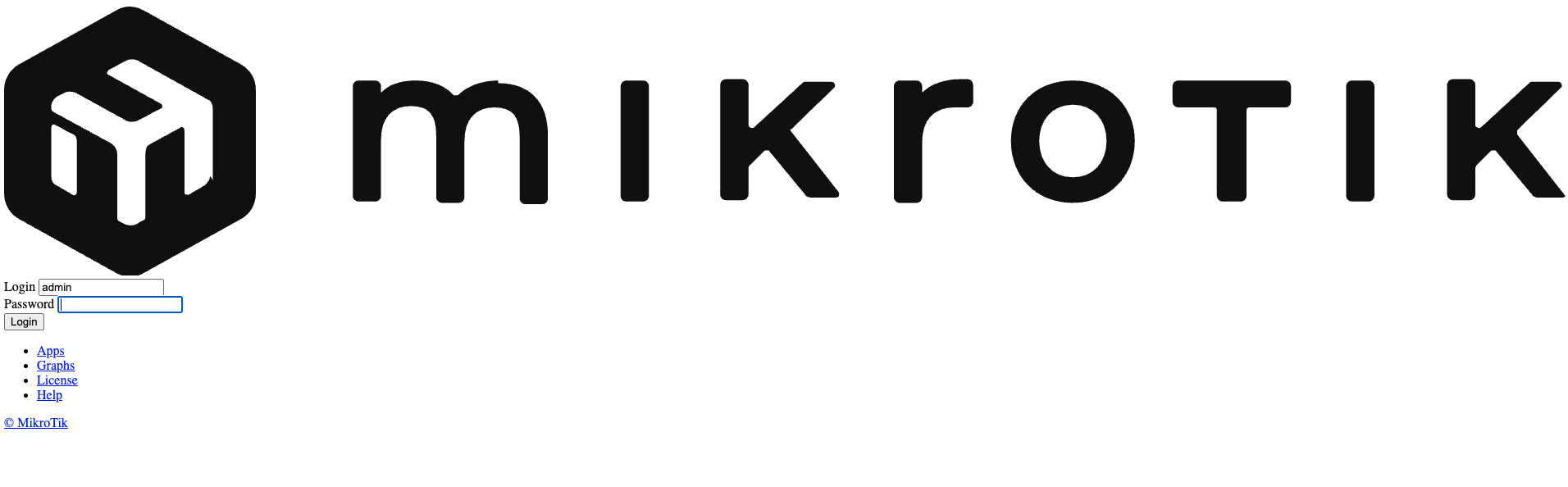

I’m facing with a strange web gui interface behaviour.
Before doing the update to the latest version 7.19.2, everything was fine.
After the update, and reboot, I couldn’t access to the web gui, it seems something is broken
I’ve reboot the unit, nothing changed.

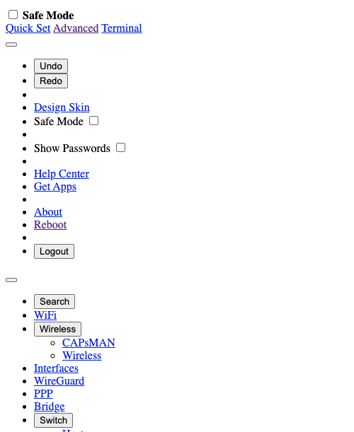

You can see it in the attached screenshot the login page, and what is shown after the login.
Below the error shown in the browser Console
master-ef1b23f04037.js:1203 Uncaught TypeError: Cannot read properties of undefined (reading 'line')
    at TermBuf.lineAt (master-ef1b23f04037.js:1203:216)
    at Terminal.ensureSpace (master-ef1b23f04037.js:1218:19)
    at Terminal.processChar (master-ef1b23f04037.js:1221:6)
    at Terminal.process (master-ef1b23f04037.js:1261:80)
    at Terminal.notify (master-ef1b23f04037.js:1269:6)
    at receive (master-ef1b23f04037.js:965:84)
    at Session.decryptUint8Array (master-ef1b23f04037.js:60:104)
    at master-ef1b23f04037.js:964:114
    at req.onreadystatechange (master-ef1b23f04037.js:853:448)

I am having the exact same behavior shown in those screenshots above, however… clearing my browser cache did not fix the issue. The webui looks broken/half loaded and will not respond.
It is taking a long time to load the webuis on my Audience devices and they’re now basically inaccessible via the webui.
