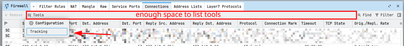

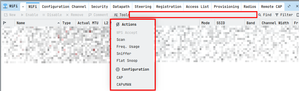

I basically like the idea to save horizontal space and have the "tools" in the toolbar instead. But this dropdown-solution needs one additional click.
What was wrong with Winbox 3 way?
Winbox 4 beta introduced the tools as a sidebar. Now trying to solve a suboptimal UX decision with another compromise.
Aside from the extra click: hiding items in a "tools" dropdown menu I do not like.
I am aware of the situation where not all tools would fit. The dropdown-menu was the easy way out.
I would like you (Mikrotik) to re-evaluate possible alternative representations. Thank you!
I don't mind a click or 2, as long as the GUI follow the mantra "use the space" or "save the space".
