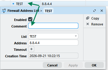

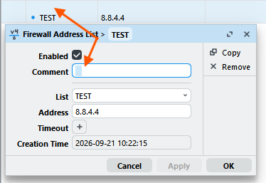

There is no special padding there. Check whether that entry has a non-empty comment. Select it and press Ctrl+M and make sure that it does not accidentally has some space characters (which are invisible) in the comment.
Space characters are invisible? Who knew? I've learnt something today.
How would anybody "accidentally" put a comment in containing only spaces?
And why does the software not strip such stupidity out before displaying it?
By ceding control of the keyboard to a cat?
Thanks for the reply. I have the comment column as a separate column. What I did find which may be the reason for the space is that if you use the address list to do a lookup it shows a + sign in the space...

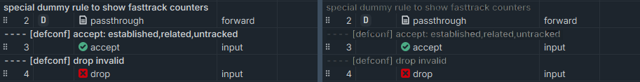

Is it possible to tint the comments slightly in both dark and light versions? Otherwise, they just blur together with the main confi
g parameters. I feel like it'd be much better for readability. Honestly, comments are a bit of a chaos right now, especially in the dark mode. Take a look at screenshot to see what I mean.
I have already asked several times for the dark theme to be improved.

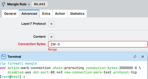

helo,
probably i found a small bug on winbox v4.4 (and v3.43 as well).
on /ip firewall mangle tab advance column connection bytes, i can put 0-5M but i can not put 5M-0
but i can put 5M-0 for the same field on CLI
I find the WinBox's behavior logical, and it should stay that way.
For sake of context - value "5M - 0" in "Connection Bytes" field means all bytes over first 5 megabytes i.e. zero in the end does mark a value of infinity. Therefore this value in "Connection Bytes" field is actually valid.
In manual it says:
super { from: num , [to] -num }
Matches packets only if a given amount of bytes has been transferred through the particular connection. 0 means infinity, for example connection-bytes=2000000-0 means that the rule matches if more than 2MB has been transferred through the relevant connection.
And there is even an example connection-bytes=2000000-0. And it matches type definition also. So 5M-0 should be valid.
@prawira have you tried 5000000-0?
hi @infabo, yes i did.
when i put 5000000-0 on cli, it show 5M-0 with red color on winbox.
it works on cli but not on winbox.

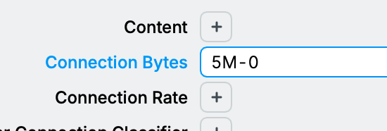

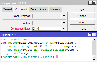

For me "5M-0" works without problems on WinBox 4.4 and ROS latest versions. As you have WinBox 4.4, what version of ROS does show this problem?
i am using winbox 3.43 and winbox 4.4
ros version : 7.21.4, 7.23.5 and 7.23.7
on all above ros version, the connection-bytes=2000000-0 give the same error on the above both winbox version but not on cli.
winbox 3.43 on chr ros 7.23.5
winbox 4.4 on chr ros 7.23.5
