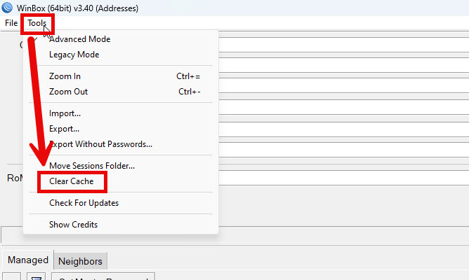

Winbox, Tools, Clear cache
I don’ have this option
Sorry…
Now I clear Cache and…the problem is the same
