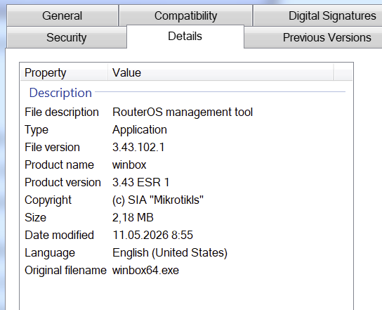

WinBox 3.43 ESR 2 (14 Jun 2026): Download (754.5 KB) | Post with details
WinBox 3.43 ESR 1 (11 May 2026): Download (761.3 KB)

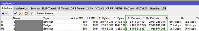

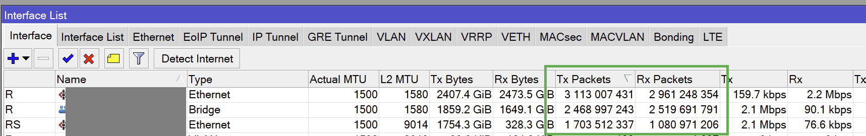

So, below is the first custom version, that fixes a multiyear bug with grouping of thousands for numbers from 10^9 and larger. This occurs in 'Interfaces' and 'Firewall' windows for packet counters, and instead of 1 234 567 890 WinBox was showing 1234 567 890. The original conversion code was fully replaced by my own code, and it works correctly with all numbers up to the highest value limit (2^64 - 1).
Result:

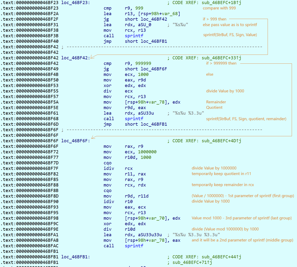

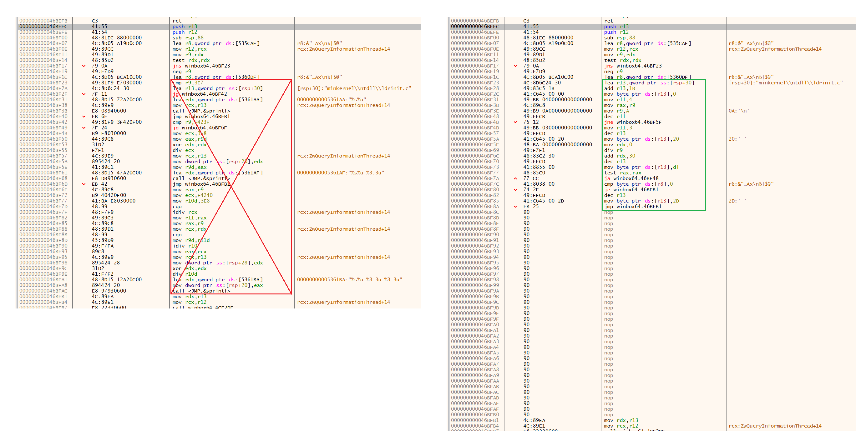

The original function, that was converting numbers is located at address 0x46BEFC (offset in .exe file is 0x0006B323). It was implemented in a very weird way. First, they are comparing a number with 999. If it's not greater, they convert it as is using sprintf function. If a number is larger, then they compare it with 999 999. In case it's not greater they divide it by 1000 and pass 2 numbers (quotient and remainder) to sprintf function, that adds space between them using format string. In case a number is greater than 999 999, they also divide it by 1 000 000 and pass 3 numbers to sprintf function. But this third number (most significant part) is left as is and not grouped. So, they simply don't care about larger numbers and maximum 3 groups can be displayed. Won't comment this implementation...
My own conversion code works simpler and just divides the number by 10 to extract every digit. At the same time it counts, how many digits were processed and adds a space after each 3 converted digits.
The code is below (x64 assembler):

This assembly code was converted into machine code and placed instead of original code. It's smaller than original code, so all remaining bytes were filled with NOP instruction (0x90). You may check .exe by yourself in some HEX editor or disassembler.

I have no idea if disassembling binary really can "reveal" how the logic was actually implemented in the higher language. Is it really possible to tell? There is a compiler that does optimizations and so on.
No, with RouterOS. As a licenses and as a part of router's cost. WinBox protocol is also a part of ROS. That's why I said, they won't open-source it.
If you understand assembler, this logic is visible, the code is short and not very complex.

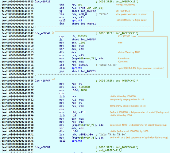

On the image in the block for Value > 999999 1st, 2nd and 3rd parameter actually means 4th, 5th and 6th parameter accordingly, I just didn't take first three into account, when commenting the code.
So, on high-level it looks like this:
if (Value > 999) {
  if (Value > 999999) {
    sprintf(StrBuffer, "%s%u %3.3u %3.3u", Sign, Value / 1000000, (Value % 1000000) / 1000, Value % 1000);
  } else {
    sprintf(StrBuffer, "%s%u %3.3u", Sign, Value / 1000, Value % 1000);
} else {
  sprintf(StrBuffer, "%s%u", Sign, Value);
If they are also coding ROS like this no wonder that there is huge bug list…
