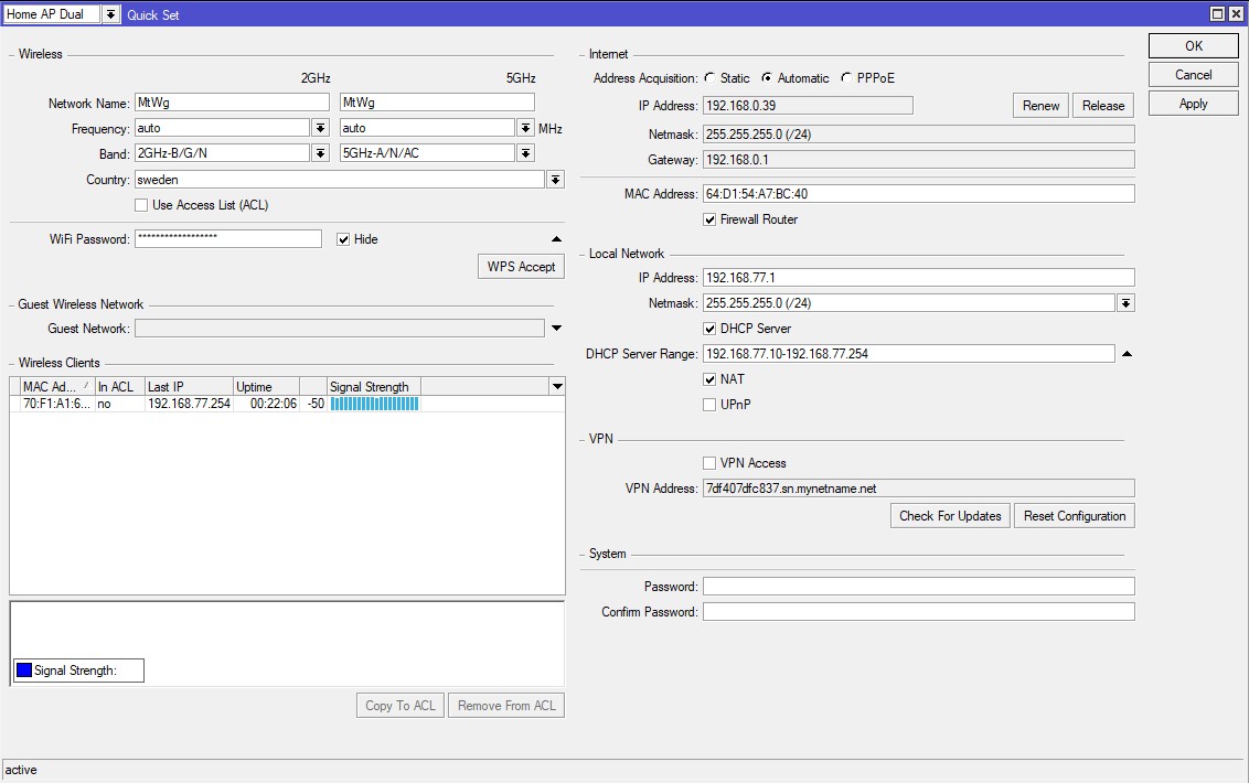

I have set up the Mikrotik as a “Home AP Dual” (see picture below).
I have tried to change a IP routing and IP firewall but I .. (mess things up)… and then I have to start all over again.
Please could anybody tell me how to get all the traffic from 192.168.77.0 network to go through the Wiregard interface?
