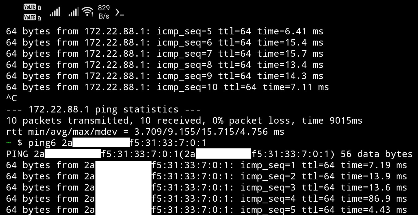

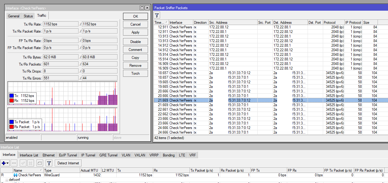

I’m sorry, WireGuard IPv6 doesn’t seem “completely broken” in 7.1rc6, here, tested with Android:
WireGuard over IPv4 endpoints.
