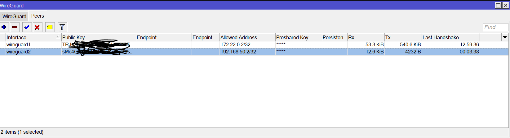

In your screenshots I see counters on both Rx / Tx and "last handshake values so it seems a connection WAS established.
I would think THE CONNECTION itself is working, but perhaps DNS not working ?
What do you mean “I don’t have a connection” ?

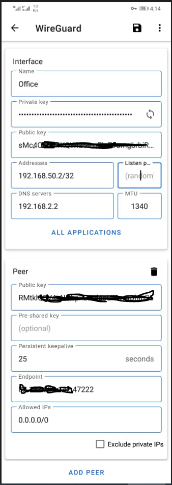

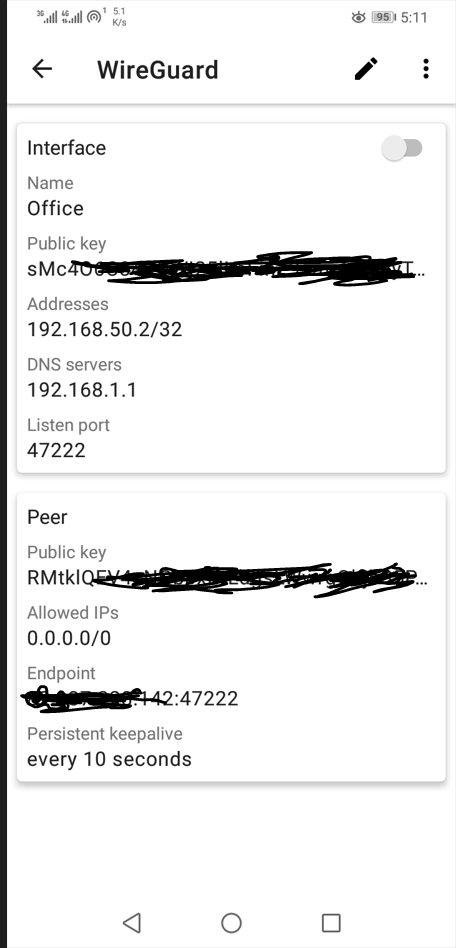

Difference I see when I look at my settings in Android (and please provide /wireguard export excluding the keys):
MTU left auto
Persistent keepalive left empty

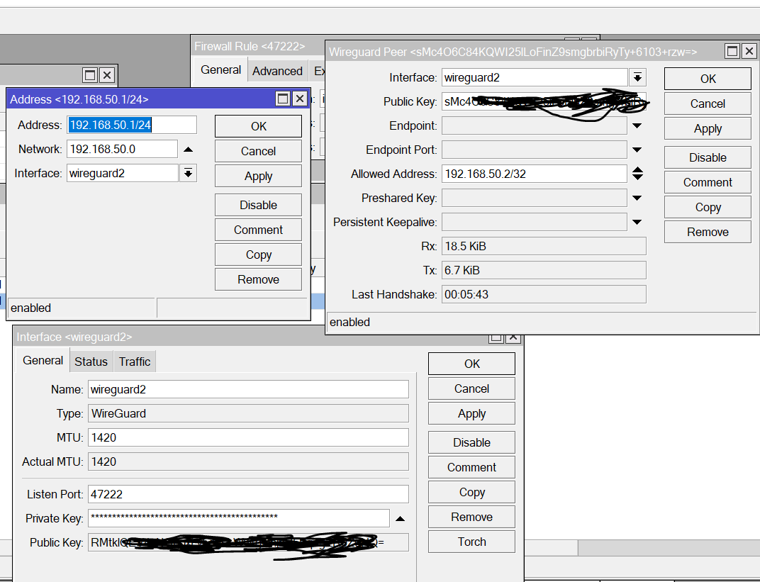

Check if the firewall filter rule is hit
Check if the peer shows on the router
yes i notice that but the connection is not exist, every 1 minute i get 2KiB -give or take- i compare those value with my PC that already have an active wireguard so there is a big difference in the value

I don’t use any keepalives on my phone-config, that field is empty.
As indicated above (and verified on my setup):
Leave MTU to auto
No persistent keepalive
0.0.0.0/0 is perfectly fine

192.168.2.2 is your local DNS server ? Already tried replacing it with the more common (and Evil :laughing: ) Google DNS 8.8.8.8 (just to rule out that problem) ?

First, try using 192.168.50.1 as DNS server on the android client, rest looks fine
Second, which config will show are the firewall rules on the MT device, which may not be set up right.
The return route from the client will be auto created at the MT so thats not an issue.

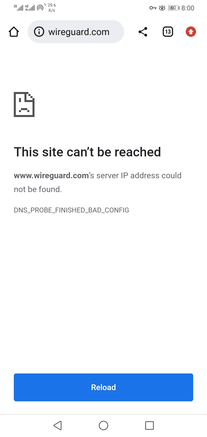

Side Note: when i turn the wireguard tunnel on my android on, i lose the internet connection, as you see in the screen below

Not that it probably makes a difference but the MTU on the android does not match the setting on the MT device.
Other than that I dont see the issue in plain sight.
What interface list wireguard belongs to ?

the MTU in client side must be lower than server side inorder for this connection to work..! .however, i try alot of different values but with no avail.
