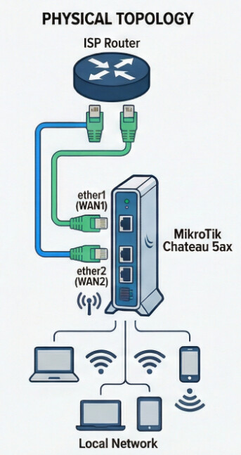

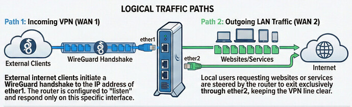

I’ve been trying several approaches but haven’t found a working solution for my setup:
  • I have 2 WAN IPs from my ISP:
    • WAN1 (ether1) – public IP, should accept incoming WireGuard connections from outside.
    • WAN2 (ether2) – behind CGNAT, should be used for normal internet traffic from local LAN clients.
  • Requirements:
    • WireGuard clients must access the local LAN.
    • WireGuard clients should also have internet access, through WAN2.
  • Hardware/Software:
    • Mikrotik Chateau 5AX
    • RouterOS 7.22rc
    • Connected via 2 ports to ISP modem
I’ve noticed that incoming UDP packets on ether1 reach the interface but never get processed by wg1 — the packets even show up on ether2 sometimes. I suspect this is related to routing tables / VRF, but I’m not sure how to configure WireGuard and routing marks properly.
Does anyone have an idea what the optimal configuration would be for this scenario? Any suggestions for routing or WireGuard setup that would satisfy these requirements would be appreciated.
Thanks in advance,
Tim
Additional diagram to clarify this case

Update after testing:
I upgraded to RouterOS 7.22rc3.
As a first attempt, I applied the solution proposed by @CGGXANNX — creating a separate routing table for WAN1 and adding a routing rule to ensure that traffic sourced from the public IP uses that table.
Also, I added NAT masquerade for both WAN interfaces as suggested, so all traffic is properly NATed to the respective WAN.
After completing the setup, everything works perfectly.
WireGuard now accepts connections via WAN1, and LAN traffic continues to use WAN2 as intended.
The internet connection is also redundant now.

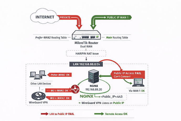

Hi everyone,
Regarding the main topic - I’m setting up an Nginx server that should be accessible via WAN1 (public IP), and I want it to have a LAN IP in the same subnet as other LAN devices: 192.168.88.20.
Other LAN devices use a routing table that sends traffic through WAN2.
My goal is for all traffic from this device (.20 Nginx ) to use the main routing table (routing via WAN1 ). The internal WireGuard server will also use the main table, while the rest of the LAN should follow prefer-WAN2.
Here are my current routing rules:
/routing rule print Flags: X - DISABLED, I - INACTIVE; * - DEFAULT
0    ;;; all-not-managed-to-main action=lookup table=main min-prefix=0
1    ;;; Headscale + Nginx src-address=192.168.88.20/32 action=lookup table=main
2    ;;; LAN-to-ether2 src-address=192.168.88.0/24 action=lookup table=prefer-WAN2
3    ;;; WireGuard-to-internet interface=wg1 action=lookup table=prefer-WAN2
Nginx diagnostic issue
From the server itself (.20), these commands work correctly:
curl -k https://192.168.88.20/health
{"status":"pass"}
curl -k https://localhost/health
{"status":"pass"}
But these do not work locally from Nginx server or LAN devices :
curl -k https://<Public IP>/health
curl -k https://<Public domain>/health
# Error:
# curl: (7) Failed to connect to <Public IP> port 443 after 0 ms: Couldn't connect to server
Interestingly, these same commands work fine from the internet.
I have configured hairpin NAT:
0 ;;; Hairpin NAT
   chain=srcnat action=masquerade src-address=192.168.88.0/24 dst-address=<Public IP> log=no log-prefix=""
Whole NAT :
/ip firewall nat print
Flags: X - DISABLED, I - INVALID; D - DYNAMIC
0 ;;; Hairpin NAT
chain=srcnat action=masquerade src-address=192.168.88.0/24 dst-address= log=no log-prefix=""
1 ;;; Nginx 443
chain=dstnat action=dst-nat to-addresses=192.168.88.20 to-ports=443 protocol=tcp in-interface=ether1 dst-port=443 log=no log-prefix=""
2 ;;; Nginx 80
chain=dstnat action=dst-nat to-addresses=192.168.88.20 to-ports=80 protocol=tcp in-interface=ether1 dst-port=80 log=no log-prefix=""
3 ;;; Nginx 3478
chain=dstnat action=dst-nat to-addresses=192.168.88.20 to-ports=3478 protocol=udp in-interface=ether1 dst-port=3478 log=no log-prefix=""
4 ;;; defconf: masquerade
chain=srcnat action=masquerade out-interface=ether2 log=no log-prefix="" ipsec-policy=out,none
5 ;;; pihole
chain=srcnat action=masquerade src-address=172.17.0.0/24 log=no log-prefix=""
…but it does not solve the issue.
When I enter my public IP in a browser from a computer on the local LAN, the MikroTik router's web page opens instead of being redirected to the Nginx server. However, accessing the same IP from the Internet works correctly and reaches Nginx.
Disabling WWW services on router does not solve the issue.**
Question:**
  • Is my routing rule setup correct for this scenario?
  • Why can’t I reach Nginx from LAN via public IP / domain, even with hairpin NAT?
  • Could this dual WAN / routing table setup cause unexpected issues with NAT or traffic flow?
Thanks in advance for any advice!
Tim
Update:
I believe I have solved the issue, and it now works as intended. Here is what I did:
  1. Added regular Hairpin NAT:
chain=srcnat action=masquerade src-address=192.168.88.0/24 dst-address=192.168.88.20
  1. Added additional dst-nat rules (one for each port):
chain=dstnat action=dst-nat to-addresses=192.168.88.20 to-ports=443 protocol=tcp dst-address=<Public_IP> dst-port=443
This is probably not the perfect solution, and CGGXANNX or RPLANT would likely come up with a better one. :slightly_smiling_face:
I hope this helps someone.
Tim
Sorry I missed you post for the past few days. I wanted to comment that this this Hairpin-NAT rule is not correct and that you should not put the public IP address in dst-address of the rule but dst-address=192.168.88.20 instead. But then I saw that in your next post that you've found that out :slight_smile:
And the other problem that was that the DSTNAT rules have the condition in-interface=ether1 so that they only work when the connections are coming from the internet, and you've figured that out too. Normally, now that you've added the DSTNAT rules that use dst-address=<Public_IP>, you can remove the old DSTNAT rules that use in-interface=ether1, because they are redundant.
If your public IP address is static (almost never change) then the solution you are using for the DSTNAT rules (dst-address=<Public_IP>) is perfect, there is nothing to improve.
In case the public IP address is dynamic and can change randomly then usually there are better solutions than hardcoding the address and having to edit the rule anytime the address change:
  • One solution is to create an address list entry with the public domain name (that points to your public IP) in the address field of the address list, then dst-address-list=THAT_LIST can be used for the DSTNAT rules instead of dst-address.
  • Another is to use dst-address-type=local dst-address=!192.168.88.1 for the DSTNAT rules.
CGGXANNX - thanks for the clarification !
