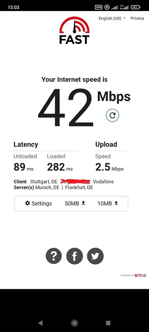

so a little update. i ran a speedtest through the wireguard tunnel using my mobile phone.. phone–>WG<–Tik—>speedtest and i get almost full upload speed @42mbps(out of 50). see screenshot below.
downloading a file from my NAS behind the Tik, through the WG tunnel only happens @ 24mbps and not close to 42mbps.. that’s half of what the actual WG tunnel can deliver. why??? is this normal?
