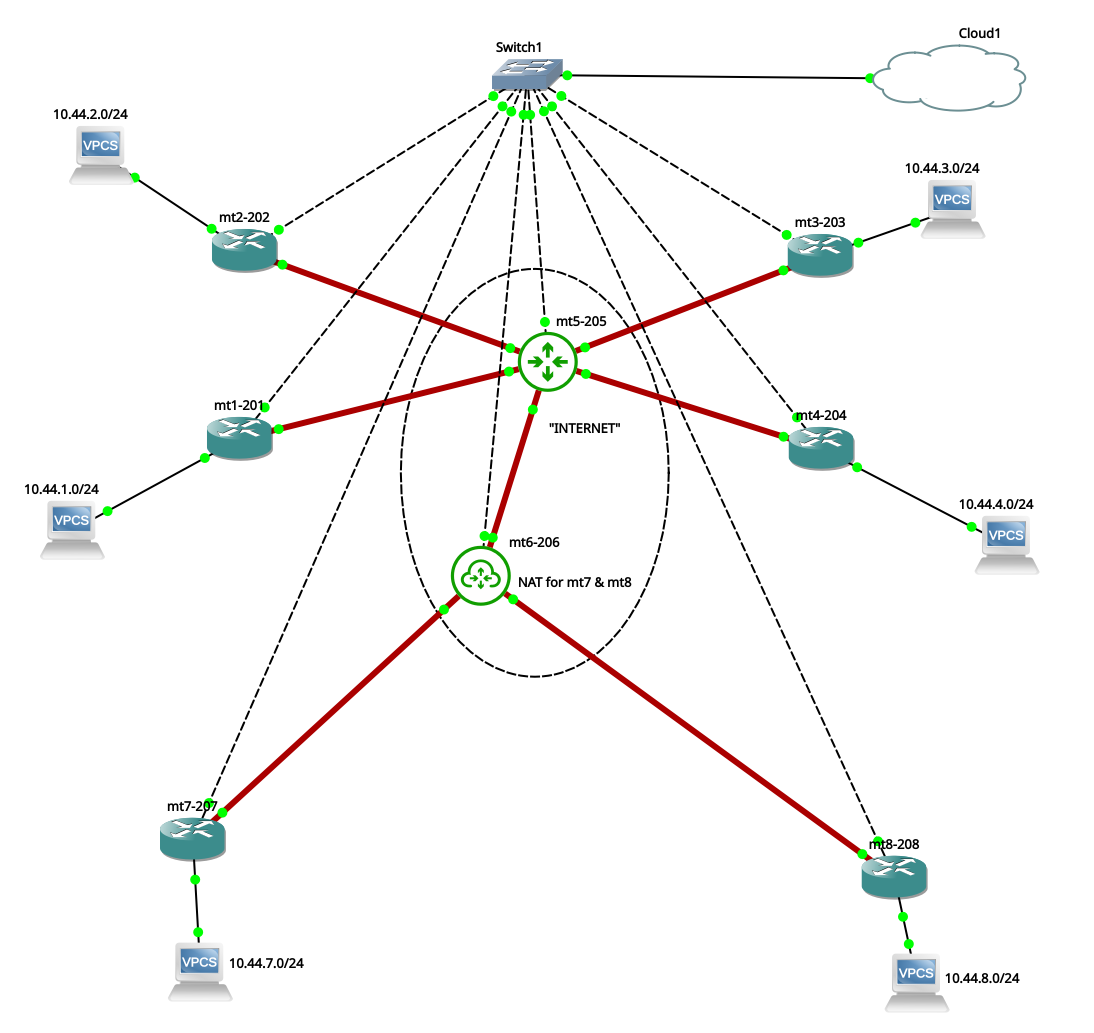

Client of mine has mulit s2s full mesh topology (attach) and I finally managed to implement wireguard (vpn interconnections) and ospf
I’m still not sure whether this was possible to solve with just one WG interface per router or not, because I still do not have enough experience with WG, but everytime I added peer with the same allowed network on the same WG interface, the whole installation failed.
So, as soon as I created WG interface for every vpn connection everything worked out-of-the box … routers mt1, … mt4 are in full mesh (3 wg interfaces each )
This is the topology in GNS3 :
routers mt5 and mt6 are playing “internet” role (10.9.0.0/16) , so there is no (ospf) broadcast between routers, and mt6 is nat-ing WG vpn connections from routers mt7 and mt8. OSPF type is “nbma”
Everything works pretty stable, ospf recalculates routes fast and accurate …
