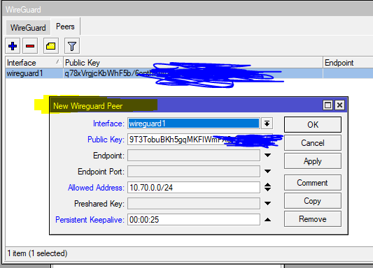

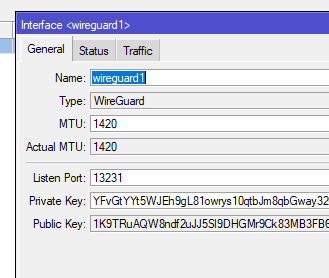

I did the following steps to setup Wireguard on 4011:
- Wireguard → New Interface. Left defaults and added private key (aaaabbbb) from config file → Apply → OK
- Wireguard → Peers → Added public key (zzzzyyyy), endpoint: 2222, endpoint port: 3333, allowed address (allowedips): 0.0.0.0/0 → Apply → OK
*The configuration file lists 0.0.0.0/0 for Allowed Address, I believe this means that all clients can use the VPN? - IP → Address → New Address → Address=10.1.1.1/32 (from interface config), Interface=wireguard → Apply → OK
