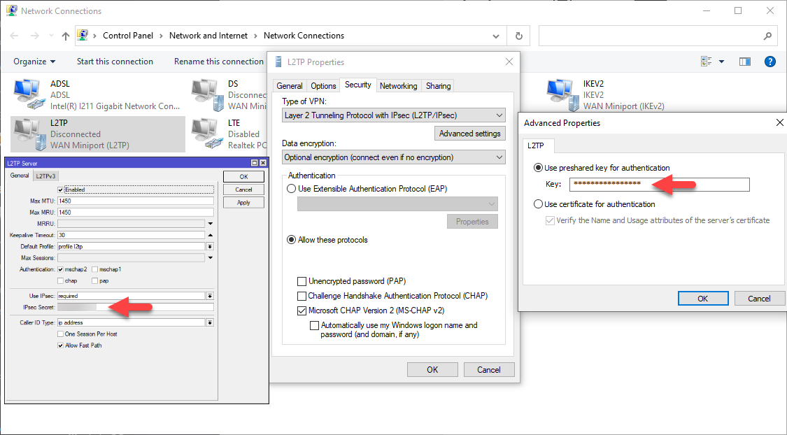

Yes, use the Windows built in L2TP+IPsec client, like this:

Ok, I tried that, but I can’t connect.
I’m using Windows 11, and when I need to select VPN type I have L2TP/IPsec with certificate and L2TP/IPsec with pre-shared key.
I select L2TP/IPsec with pre-shared key but where do I get that key ? I entered my password and when i tried to connect i get error message in windows saying: "The network connection between your computer and the VPN serrver could not be established because the remote server is not responding.

It’s a bit incomplete. It should be better with this:
/ppp profile
add local-address=192.168.89.1 name=vpn remote-address=vpn
/ppp secret
add name=<l2tpusername> password=<l2tppassword> profile=vpn service=l2tp
/interface l2tp-server server
set authentication=mschap2 default-profile=vpn enabled=yes ipsec-secret=<ipsecsecret> use-ipsec=required
Also add ipsec-policy=in,ipsec to firewall rule for port 1701, because you want L2TP only with IPSec. And don’t forget to disable PPTP and SSTP, if you don’t plan to use them.

Now I’m getting: phase 1 negotiation failed due to time up. I made new VPN connection on client PC with pre-shared key I entered during setup.
The rule you changed from original port 4500 is wrong, it was correct before. I meant to change original rule for port 1701. Both ports 500 and 4500 can also be combined in one rule. And I forgot one more, even though it probably won’t be used much, because client is going to be usually behind NAT. So the right rules you need are:
add chain=input protocol=udp dst-port=500,4500 action=accept
add chain=input protocol=ipsec-esp action=accept
add chain=input protocol=udp dst-port=1701 ipsec-policy=in,ipsec action=accept

This router is connected to my ISP DSL router but i assigned static ip address to my mikrotik and i put that IP address in DMZ so ISP’s router firewall shouldn’t be a problem.
Is maybe a problem that i checked VPN box at first setup ? I can see now that after all config changes box is not checked anymore.
That’s problem with client. Microsoft assumes that server has public address directly, i.e. it’s not behind NAT. And when it is, Windows need to be told to work with it:
https://docs.microsoft.com/en-us/troubleshoot/windows-server/networking/configure-l2tp-ipsec-server-behind-nat-t-device
You want value 2. I don’t understand why they didn’t change defaults already. It doesn’t really reinforce the claim that L2TP/IPSec is easy to use. :slight_smile:
One more thing, I didn’t examine the latest config at first, but now I quickly checked it, and added firewall rules are in wrong place. Order of firewall rules matters. They should be where your original ones for given ports are. But since you already have yours, remove mine and just update yours for port 1701 (add ipsec-policy=in,ipsec to it). You can keep mine for protocol=ipsec-esp, but I think it probably won’t do anything for server behing NAT (I’m almost sure, but not entirely 100% sure).
