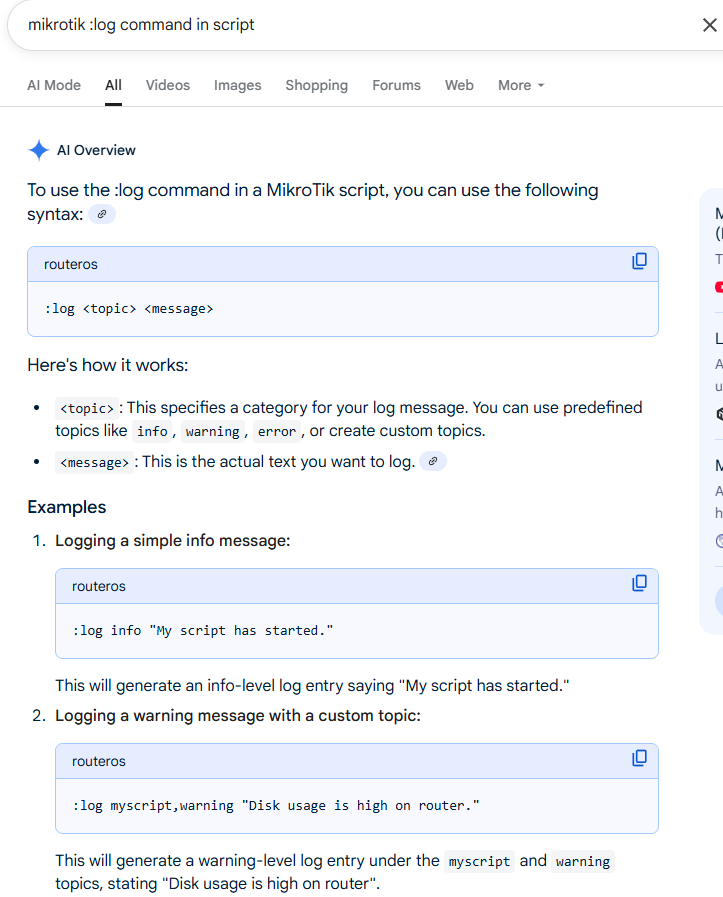

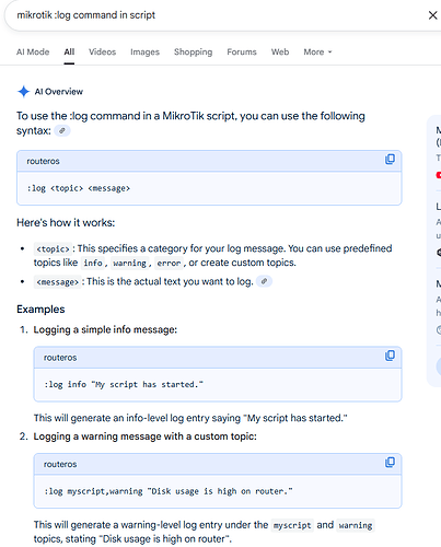

I’m not advocating AI, but just as a point of reference to how bad the info out there is:
Well, regarding :log command, MikroTik’s scripting documentation is quite clear :slight_smile:
Other topics are generated by RouterOS, you can’t use them.
AI, well, it’s stupid sometimes. Though, I’m using it to generate regexps, I just can’t handle them with my head :exploding_head:

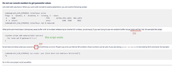

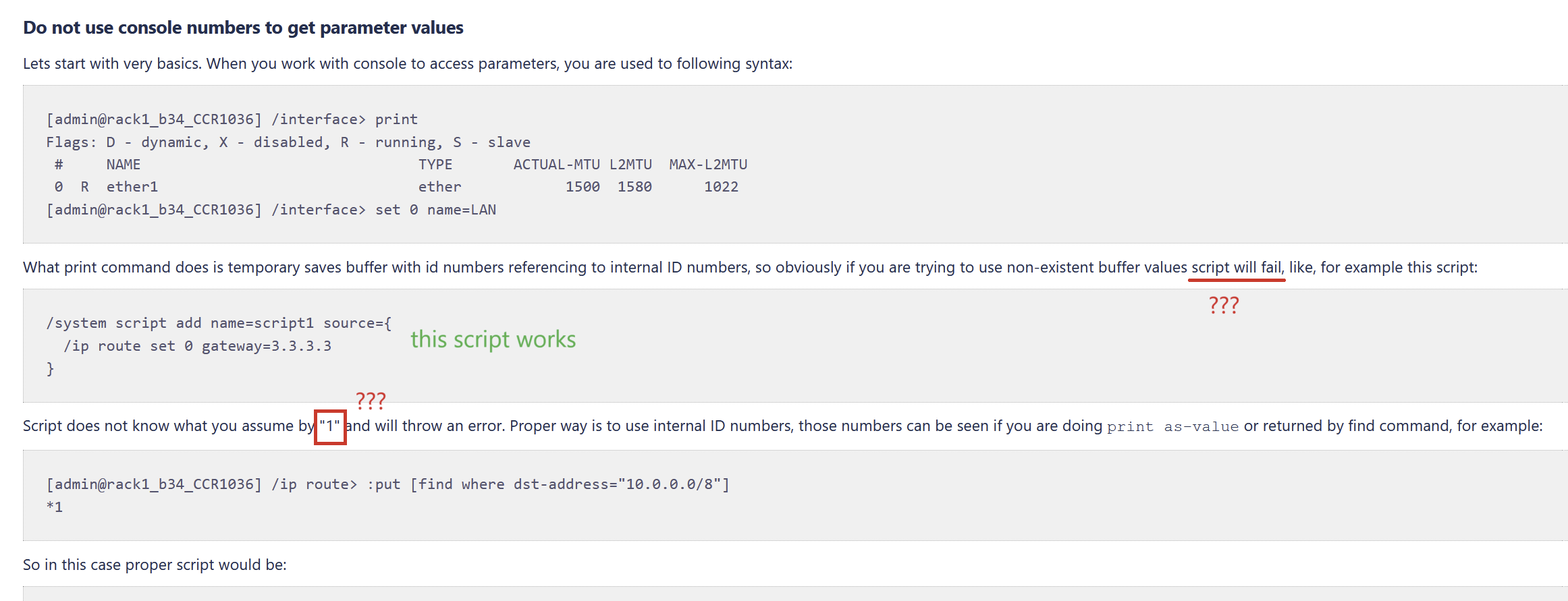

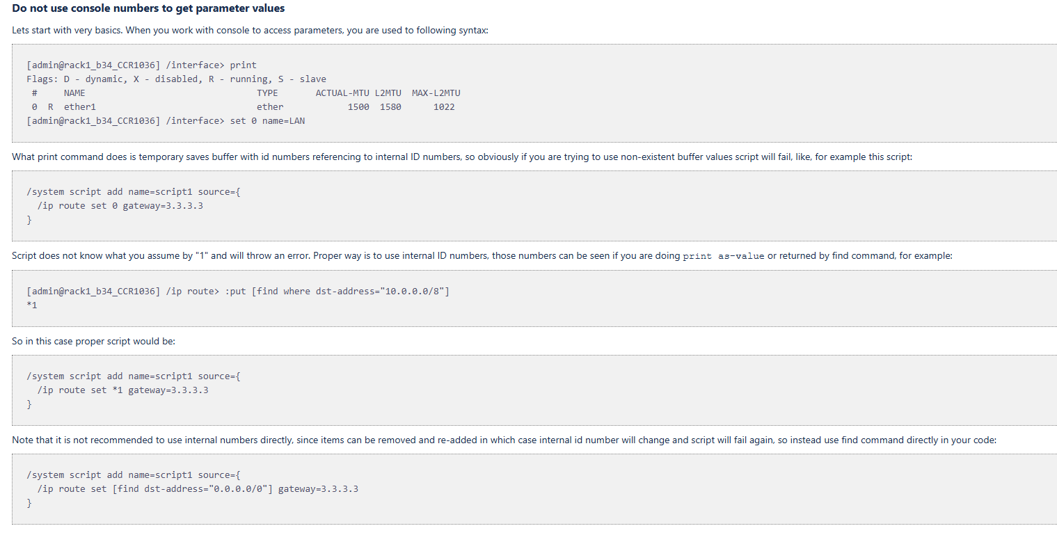

The issue is described in the first item on the “Scripting Tips and Tricks” documentation page:
Do not use console numbers to get parameter values
Thank you. I found the referenced page.
I know you’re all going to this I’m being dense, but I know that this is far from clear – I think the point of not using id numers is that they can change. But, it shouldn’t be far more work to figure out what is being said than understanding the underlying concept.
Further, is there any merit to my observation that hard coding the UPS name has its own problems?
If you have only one ups and you say its name could change, then using 0 won’t be a problem.
Btw, these docs are quite strange. Why do they say, that the second script will fail? It works fine. What do they mean by “1”? They were using 0 index in the script code and then they write “1”. Is it a typo? Weird.
