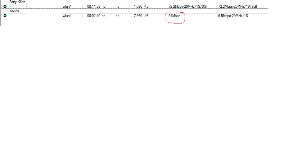

Hello colleagues.
Briefly the issue. I’m bought phone Xiaomi Redmi note 2 prime. And at all available to me Mikrotik devices phone can’t be connect faster than 54Mbps to TX data
https://www.dropbox.com/s/lbqo7asxu6rixew/Выделение_314.png?dl=0
Tested on RB 951G-2Hud, hap lite old and new one version (RB941-2nD и RB941-2nD-TS) is the same behavior.
Your colleagues from support who been on the MUM in Ukraine 8 Dec 2015 have not been able to resolve the issue but recognized problem. They said contact on the support.
The problem is also present in other owners of phones of this brand, as can be seen from the frequent posts 4pda and other sites, for example http://en.miui.com/thread-35456-1-1.html
When testing with other routers ASUS (DD-WRT) and the tp-link (default FW) allowed in both directions for 40 megabits and 65 respectively. Tested downloading and uploading to an ftp server in a local Gigabit network.
As tested on Zyxel Keenetik (diff verions)also no problem.
Changing the parameters of the wireless router to give nothing except further deterioration rate.
I hope for early resolution my problems.
