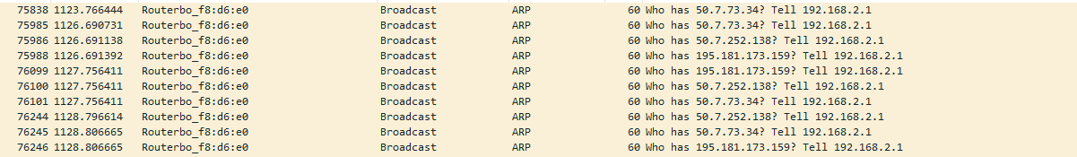

I happened to be running wireshark and noticed my RB4011 is sending ARP’s for public IP’s on my LAN. I confirmed I do not have proxy-arp running.

ARPS:
UPDATE:
This appears to be zerotier related.

I realize my first post was not clear as I was still discovering the problem. So here is some more information:
The IP’s that the router is ARPing for is PLANET and LEAF’s from zerotier.
The packet capture is from my LAN, as seen from my home computer. zerotier terminates on the router as a seperate layer 3 interface, so this packet capture would never see zerotier interface traffic.
  • I updated firmware and confirmed the problem still exists.
  • Arp is a layer 2 protocol, and not complex at all. It should not be ARPing for a ip address that is not in the same layer 2 subnet.
  • ARP does not help a router with path resolution. (routing is a layer 3 function)

Thanks for the reply.
You are correct when you use a interface route the route becomes active when the interface is up and it considers every destination address as directly connected to that interface, so it will ARP for the destination’s filling up your table. But this is not the scenario I am explaining above. The router is sending public IP ARP’s out the local interface with a /24 RFC1918 subnet. I have not checked my WAN interface but I guess I should.

My router appears to be acting appropriate on the WAN
[[REDACT]@router1] /tool/sniffer> packet/print detail
 0 time=33.477 num=1 direction=rx src-mac=00:01:5C:92:AA:46
   dst-mac=FF:FF:FF:FF:FF:FF interface=eth1 protocol=arp size=60 cpu=0
 1 time=33.529 num=2 direction=tx src-mac=C4:AD:34:F8:D6:DF
   dst-mac=00:01:5C:92:AA:46 interface=eth1 protocol=arp size=42 cpu=3
 2 time=33.537 num=3 direction=rx src-mac=00:01:5C:92:AA:46
   dst-mac=C4:AD:34:F8:D6:DF interface=eth1 protocol=arp size=60 cpu=0
 3 time=46.004 num=4 direction=rx src-mac=00:01:5C:92:AA:46
 4 time=66.935 num=5 direction=rx src-mac=00:01:5C:92:AA:46
 5 time=75.769 num=6 direction=tx src-mac=C4:AD:34:F8:D6:DF
   dst-mac=00:01:5C:92:AA:46 interface=eth1 protocol=arp size=42 cpu=1
 6 time=75.78 num=7 direction=rx src-mac=00:01:5C:92:AA:46
 7 time=96.511 num=8 direction=rx src-mac=00:01:5C:92:AA:46
 8 time=118.019 num=9 direction=tx src-mac=C4:AD:34:F8:D6:DF
   dst-mac=00:01:5C:92:AA:46 interface=eth1 protocol=arp size=42 cpu=2
 9 time=118.029 num=10 direction=rx src-mac=00:01:5C:92:AA:46
10 time=132.868 num=11 direction=rx src-mac=00:01:5C:92:AA:46
11 time=147.604 num=12 direction=rx src-mac=00:01:5C:92:AA:46
12 time=160.249 num=13 direction=tx src-mac=C4:AD:34:F8:D6:DF
13 time=160.256 num=14 direction=rx src-mac=00:01:5C:92:AA:46
14 time=184.963 num=15 direction=rx src-mac=00:01:5C:92:AA:46
15 time=202.489 num=16 direction=tx src-mac=C4:AD:34:F8:D6:DF
   dst-mac=00:01:5C:92:AA:46 interface=eth1 protocol=arp size=42 cpu=0
16 time=202.496 num=17 direction=rx src-mac=00:01:5C:92:AA:46
17 time=202.699 num=18 direction=rx src-mac=00:01:5C:92:AA:46
