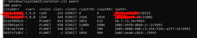

i checked the links between peers(pc-hap ac3) on the zerotier central and using the zerotier-cli on windows, they show a direct(non relayed) connection, and the respective public IPs are also showing up properly. ping times also give away a direct link. Any suggestions on improving my speeds would be appreciated.

My peers make a direct connection, not relayed. Isnt this the fastest link possible? From my understanding, the ZT central is just for letting peers know about the configuration and possible changes. But once the link is established, the peers communicate directly (see 4. in your link). The public IP addresses are accurate and i checked the links (which are direct) using the cli. So what am I missing?

also. heres a picture of the direct links between my windows 10 machine and the Mikrotik peer.

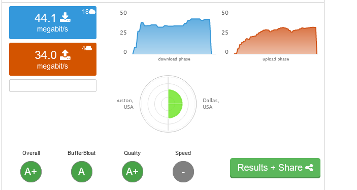

My test topology:
PC -->Microtik<-zerotier->opnsense in cloud–>internet
results: (maxed my upload speed)
well, it’s definitely not Zerotier then. what’s your RouterOS?
