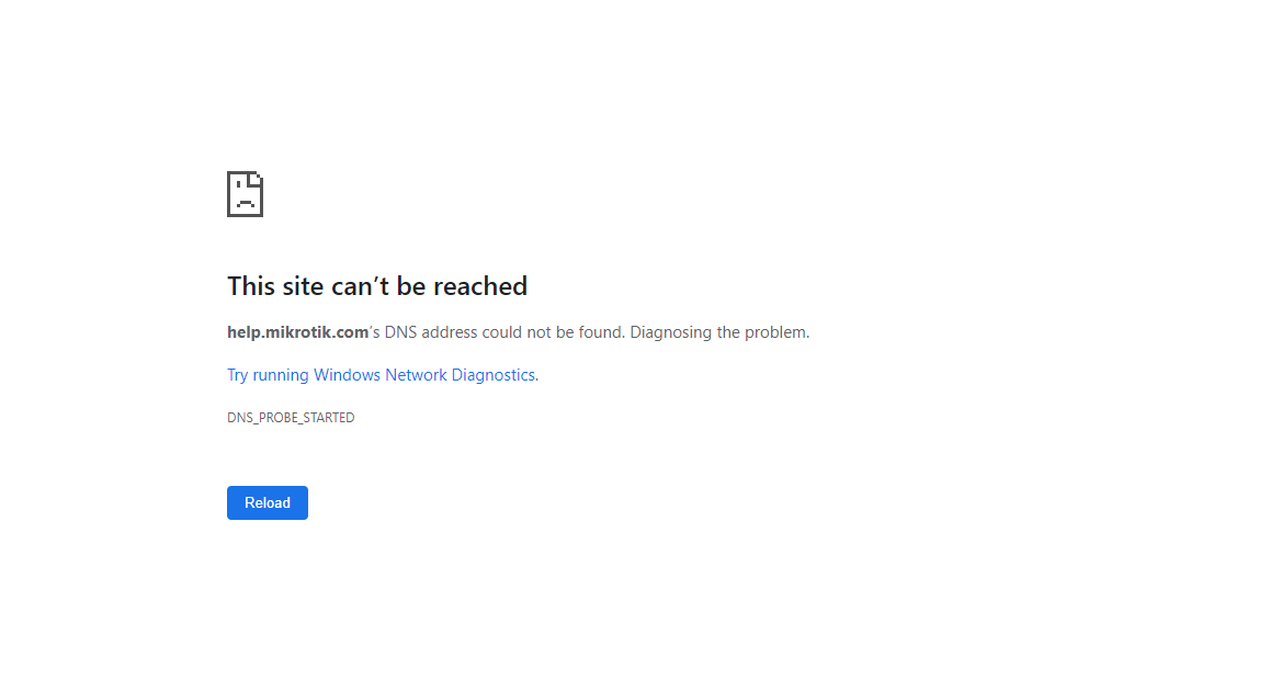

DNS ALWAYS CRASHES DOWN IN THE NEW VERSION !!!
I already submitted a ticket SUP-117224

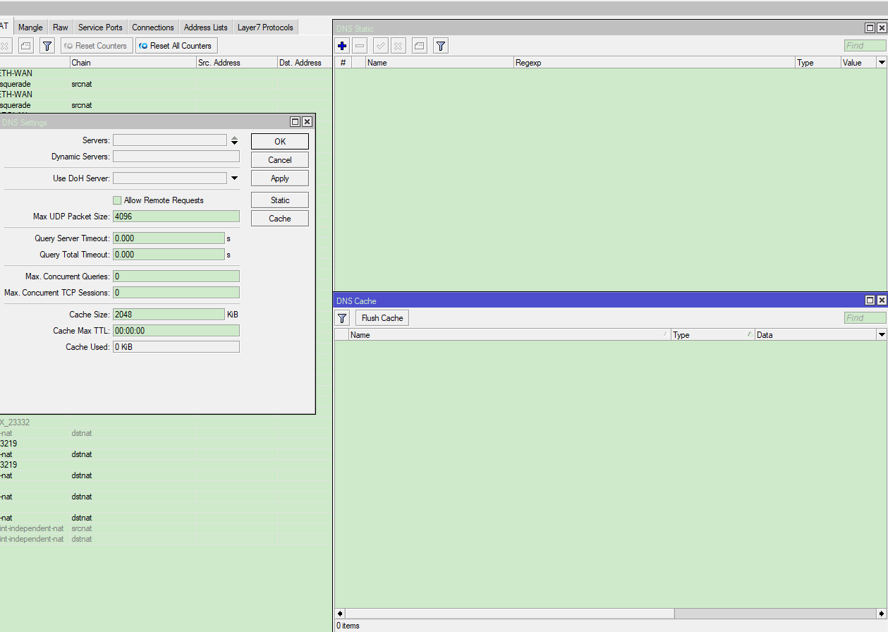

Sooooooo, did noone notice the 0.000 second timeout values?
That automatically fails any dns request made. Same with the 00:00:00 second TTL…

Maybe if something in that service is broken, settings can’t be read and those are the default (not default service values, but default GUI values shown)?

Way in the past, in some v6.xx version, one time I have seen the same thing on my router: timeout values suddenly zero, all DNS queries fail.
No idea what has caused it. Of course easy to fix.

It is not a “DNS server crash”, it is configuration of the DNS with unusable parameters.
It would have to be found how that happened, but that likely cannot be traced anymore now.
Just reset the configuration to correct values and be done with it!
In other words, you can trash the DNS service with just setting some unsupported value in some setting that doesn’t have input validation?
Interesting.
