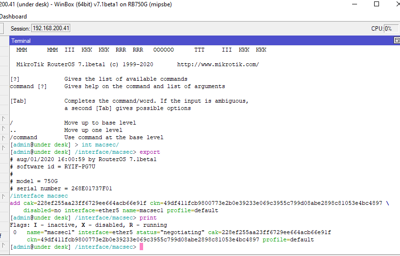

Hi, just wondering if there is any formal documentation for Mikrotik’s 802.1AE (AKA MACsec) in RoS v7.
Given its been in RoS v7 at least since its early beta release I was hoping to see some doco on it by now.
As of yet I have not got it working between devices( Get as far as it ‘negotiating’, and can see specific 802.1AE traffic via torch).
Is there a particular hardware requirement for it to work, or is it going to be a kernel feature no matter the HW ?
/interface macsec
add cak=228ef255aa23ff6729ee664acb66e91f ckn=49df411fcb9800773e2b0e39233e069c3955c799d08abe2898c81053e4bc4897 \
    disabled=no interface=ether5 name=macsec1 profile=default
[admin@under desk] /interface/macsec> print
Flags: I - inactive, X - disabled, R - running
 0   name="macsec1" interface=ether5 status="negotiating" cak=228ef255aa23ff6729ee664acb66e91f
     ckn=49df411fcb9800773e2b0e39233e069c3955c799d08abe2898c81053e4bc4897 profile=default
