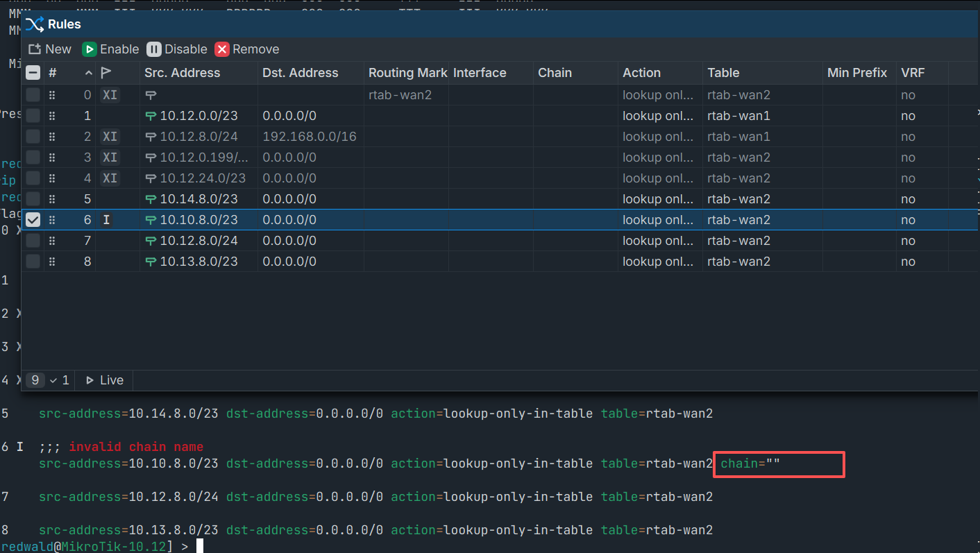

A bit problem with routing rule on ros 7.22rc3 and winbox4.0.1
routing/rule item would appears to be invalid when reenabled or newly created.
an empty option is added in the CLI configuration even when “chain“ option is not enabled in th GUI
problem is observed on rb5009, hapaxs,hapax2
on ros 7.22rc2 this problem would not occur since there is no chain option in GUI

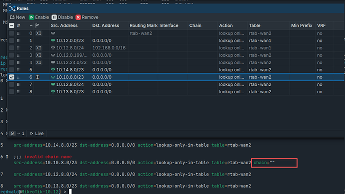

It's probably a problem with wrong default value in the metadata sent to WinBox. You can manually fix it by setting the chain to user. Or use the unset command in the CLI.
/routing rule print
/routing rule unset 6 chain
