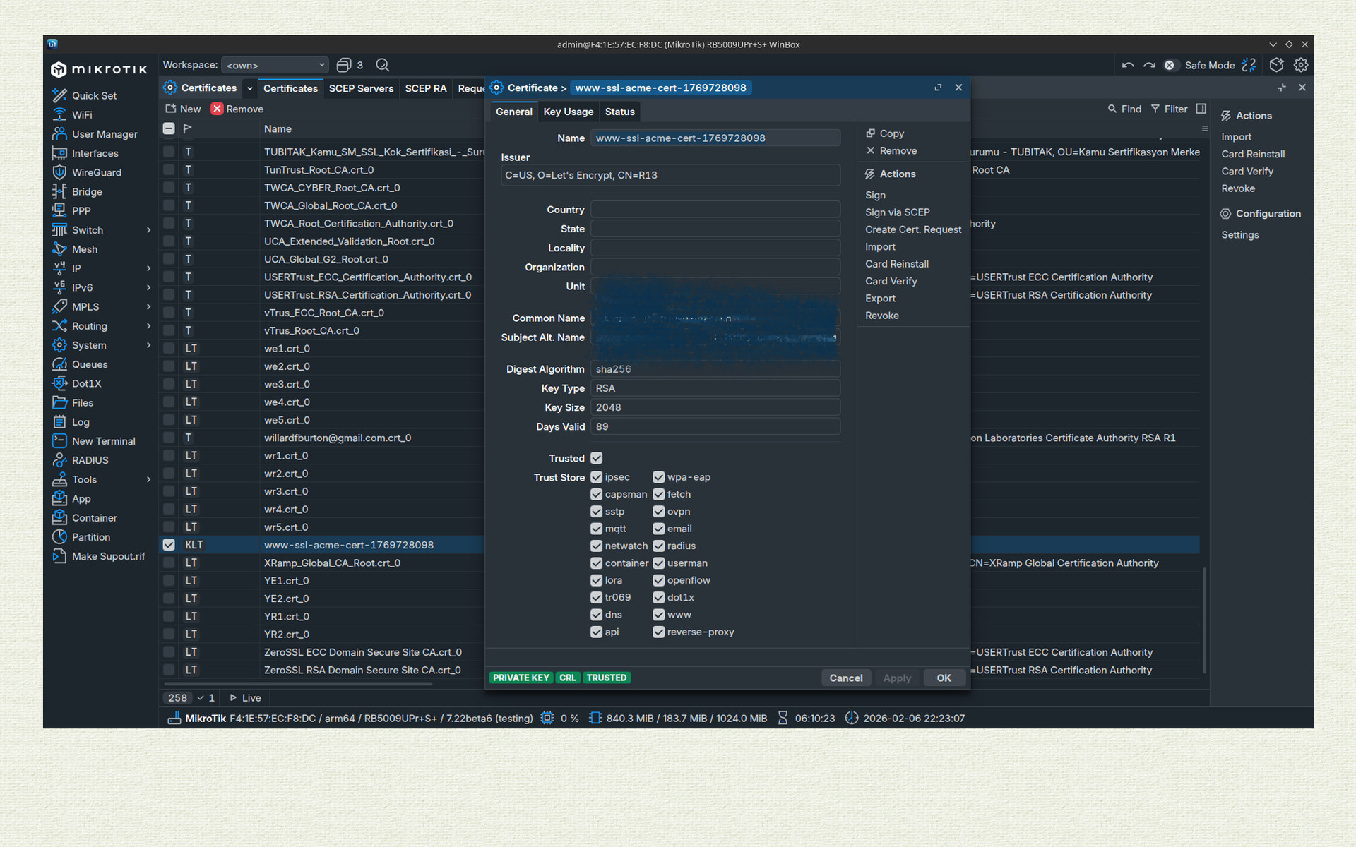

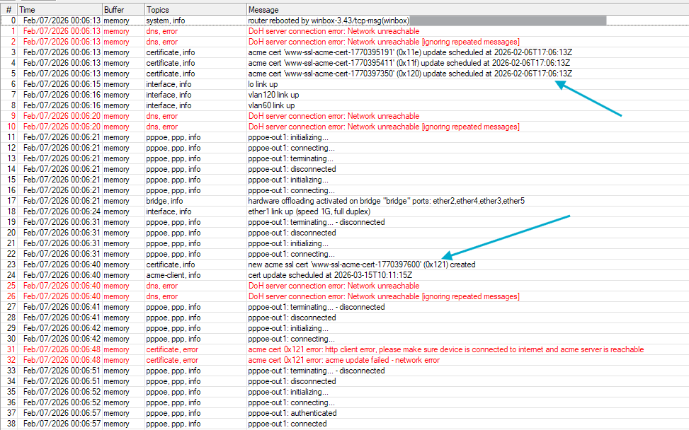

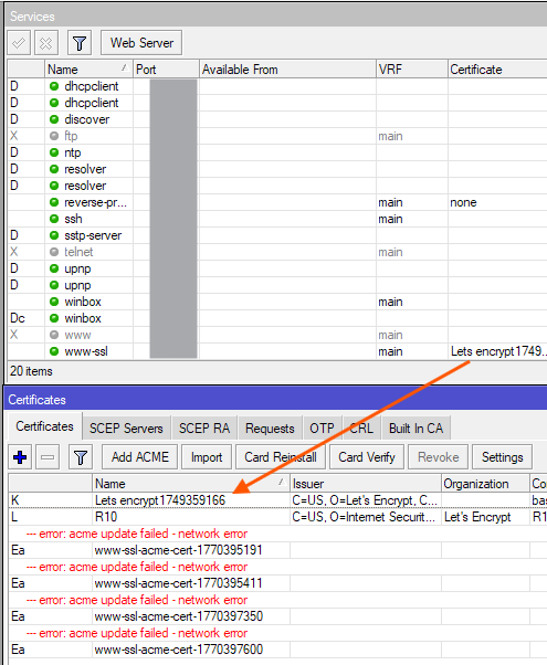

Does this have something with this error appearing in the log at boot:
And the appearance of these broken certificates:
My www-ssl service use an ACME certificate (with Let's Encrypt) with a custom domain, and that certificate is still there and valid, and assigned to www-ssl. However, I don't recall having ever added or touched the two in the screenshot above.
EDIT: Another reboot and now there are 3 of them :open_mouth:
Ok, I can now confirm that one is added for each reboot:

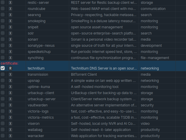

My technitium broke when I upgraded was using DoT, anyway cleaned up and re-pulled all good.
Also what is this RED Certificate ?

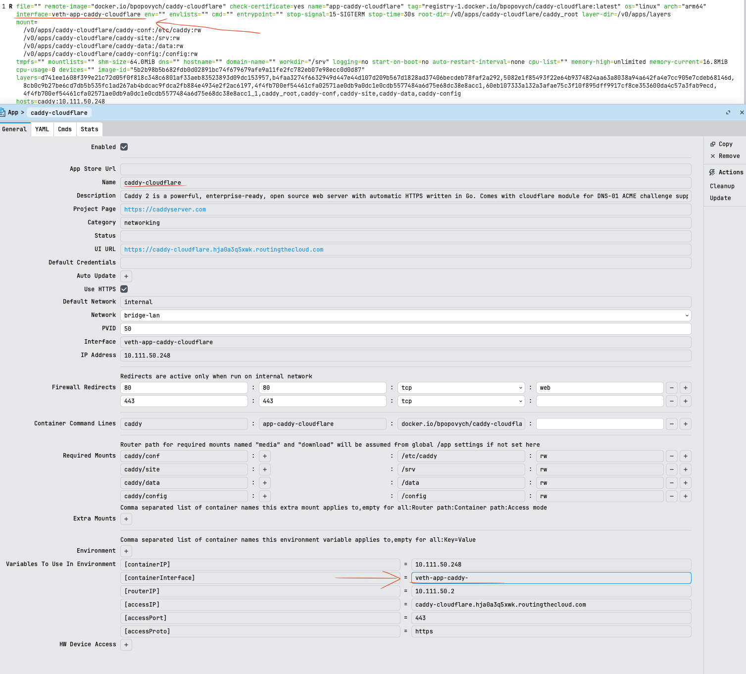

A minor WinBox thing: in the App → detailed info about container the [containerInterface] does not show full veth interface name, truncates after a dash - for a long container name with dash. Command line displays name correctly and all works fine.
Do you remember which one is the original acme cert? I’m assuming it’s the one is 1770395191.
Can you look and see if it’s marked as trusted?
Also, can you check the acme directory url? What do you have?
I think it should be
https://acme-v02.api.letsencrypt.org/directory
You may need to downgrade to the previous version and then set www-ssl-acme-cert as trusted.
The [containerInterface] reflects the Linux device name in container. For some reason (perhaps there is max length of interface name, IDK...), it actually does truncate the name inside the container. So if you do some ifconfig or ip link, you'll actually see the truncated name there. But since it's truncated (again IDK why), but the [containerInterface] variable should match the name inside the container, and the "outside" (RouterOS) VETH name in /app ... interface= does show the "full name".
Now why it truncates it when creating a container IDK why... And if for some reason it does need to be truncated... it the last part that should be saved, perhaps strip veth- e.g. veth-app-mycont vs app-mycontainer

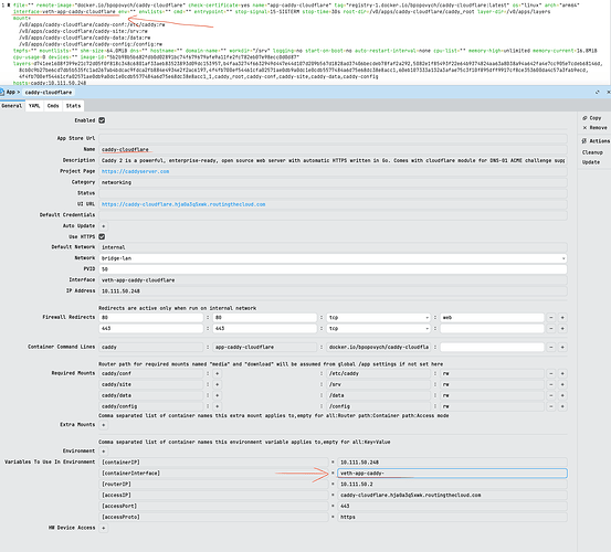

Indeed @Amm0 - thanks for pointing to this. If I start two containers, one custom with a dash in it’s name - the interface name is truncated:
[mikrotik@mikrotik] /container> shell 0
mikrotik:/# ifconfig
lo        Link encap:Local Loopback
inet addr:127.0.0.1  Mask:255.0.0.0
inet6 addr: ::1/128 Scope:Host
UP LOOPBACK RUNNING  MTU:65536  Metric:1
RX packets:0 errors:0 dropped:0 overruns:0 frame:0
TX packets:0 errors:0 dropped:0 overruns:0 carrier:0
collisions:0 txqueuelen:1000
RX bytes:0 (0.0 B)  TX bytes:0 (0.0 B)
veth-app-goaway Link encap:Ethernet  HWaddr 5A:F9:ED:84:7A:CB
inet addr:10.111.50.249  Bcast:0.0.0.0  Mask:255.255.252.0
inet6 addr: fe80::58f9:edff:fe84:7acb/64 Scope:Link
UP BROADCAST RUNNING MULTICAST  MTU:1500  Metric:1
RX packets:7047 errors:0 dropped:0 overruns:0 frame:0
TX packets:1825 errors:0 dropped:0 overruns:0 carrier:0
RX bytes:1249185 (1.1 MiB)  TX bytes:159341 (155.6 KiB)
mikrotik:/#
exit
done
[mikrotik@mikrotik] /container> shell 1
/ # ifconfig
veth-app-caddy- Link encap:Ethernet  HWaddr 6A:76:71:79:C5:4A
inet addr:10.111.50.248  Bcast:0.0.0.0  Mask:255.255.252.0
inet6 addr: fe80::6876:71ff:fe79:c54a/64 Scope:Link
RX packets:4915 errors:0 dropped:0 overruns:0 frame:0
TX packets:96 errors:0 dropped:0 overruns:0 carrier:0
RX bytes:475895 (464.7 KiB)  TX bytes:24787 (24.2 KiB)
I started another pre-build container with a dash in its name - uptime-kuma, for this container [containerInterface] is shown as “veth-app-uptime” - at least there is no trailing dash at the end.
So looks like a but or at least minor inconsistency.

I looked it up. Linux kernel limits name to 15 chars, so the ending - is more that your at the 15 char limit, so RouterOS truncates it.
While some truncations may be needed... agree it should be "smarter" as the prefex is always veth-app-, you're left with 7 chars right now.

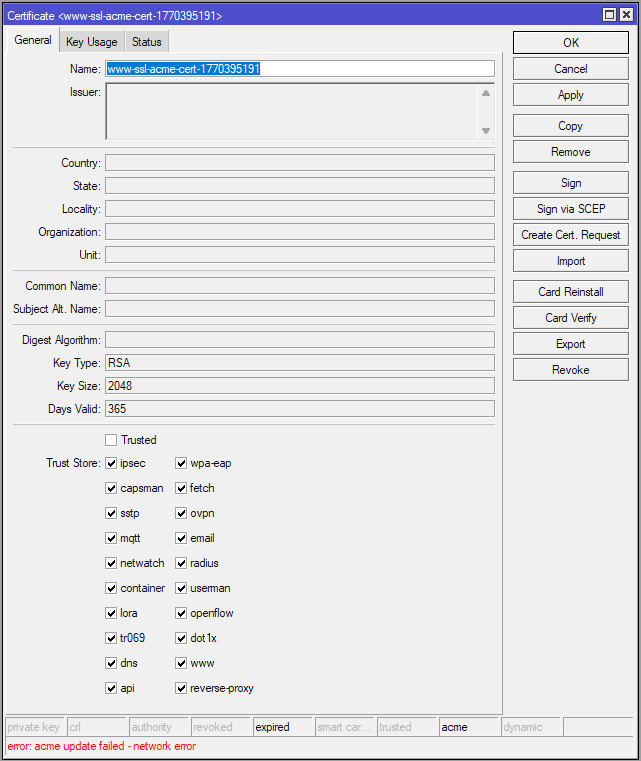

None of them are the original certificate. As I wrote above, the original working certificate is still there and assigned correctly to the services (www-ssl, api-ssl and SSTP), and is still valid until April.
I've never added or changed anything with www-ssl-acme-cert in name. This is my test RB750Gr3 and before the upgrade from beta6 to rc1 there were only the two certificates first listed in the screenshot. That Lets encrypt1749359166 certificate has been there and in use since quite a while, and went through multiple renewals. As you can see from the Unix timestamp in the name, it has been named like that since June 8, 2025.
As for those 4 bogus certificates, they seem completely broken with no valid information:
From the log, at boot the router mentioned that the 3 bogus certificates needed to be renewed, and then created the 4th one afterwards.
However, automatic renewal for ACME certificate on this router will never work, because www is explicitly turned off, and port 80 is not open in the firewall, and the Lets encrypt1749359166 cert uses my sub domain, not the IP Cloud one.
Another thing that might cause the above, is that this router will never have internet connectivity in the first 30+ seconds after boot. It's connected to a port with 802.1X active, but is not configured as 802.1X client. The router normally has to wait for 30s for the upstream port to switch to guest mode (after receiving no authentication attempts) and put it in the guest VLAN, where the upstream PPPoE server is available. Only then it can have internet connectivity.
I am guessing that the change in rc1 might be that the router now tries to create the ACME certificate for the IP Cloud domain in any case, even when the services are already configured with the custom domain ACME certificate. However, at boot it has no internet connectivity and cannot contact MikroTik's server to confirm the IP Cloud domain and using the help of remote server to request the certificate with DNS-01. That could explain why the bogus certificates have no CN or SAN information.
This is what I did.
Remove the bogus certificates and create a new acme certificate with the name www-ssl-acme-cert-1749359166
It’s important to use the same Lets encrypt 1749359166.
Use the acme directory url
Once it's created it won’t let you mark it as trusted.
I had upgrade to 7.22beta6. After the upgrade go to the acme certificate www.-ssl-acme-cert-1749359166 and mark it as trusted.
This is how I got around this error.
I haven’t tried going to 7.22rc1
I got busy doing other things. But you might wanna tried what I did.
Note: I also thought it was an open port issue. So, I opened up port 80 and port 443 but that didn’t make any difference. I also took a look at the MT docs and seen that the acme directory url was pointing to a Zero trust SSL directoy url? Did MT have a fallout with Let’s Encrypt and gone to Zero trust.
