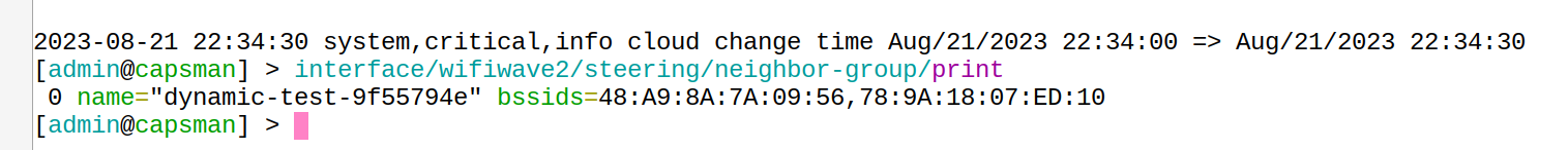

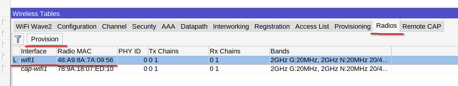

I also see a lot of people struggling whit local WiFi interface provision to capsman configuration (for example if you have ax3 and cap ax, and you want to use one of APs as server). You don’t have to setup local wifi interface to use capsman server, but need to provision from “Radios” tab manually. As you provision that local interface it will be managed by provision configuration same way as remote WiFi interfaces. Also kvr is working, interfaces show up in the same neighbor group (at least on 7.12beta1).
