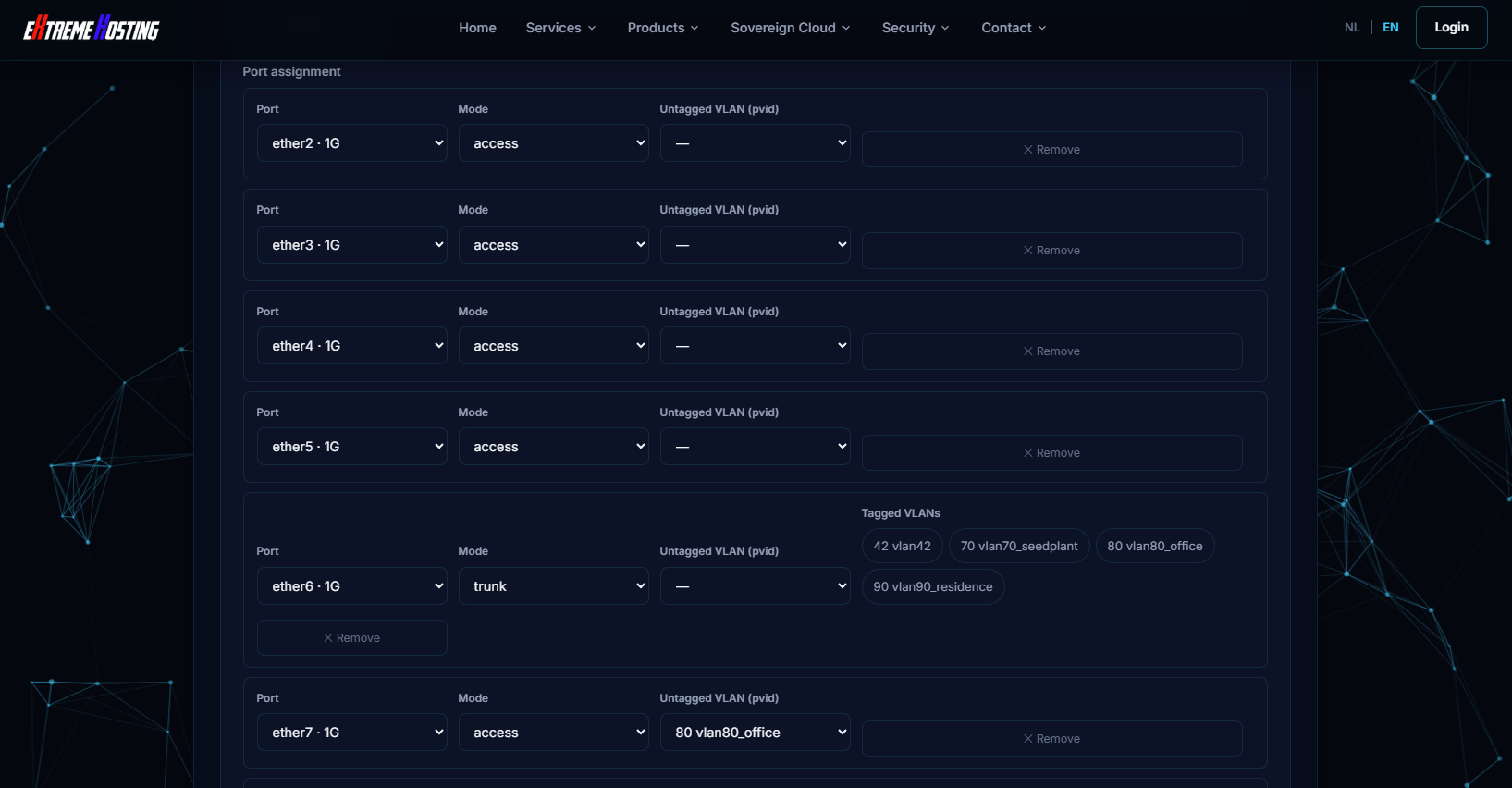

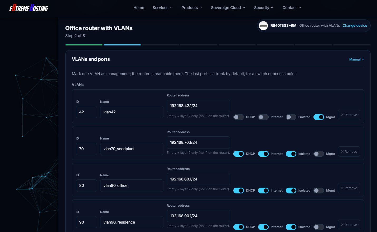

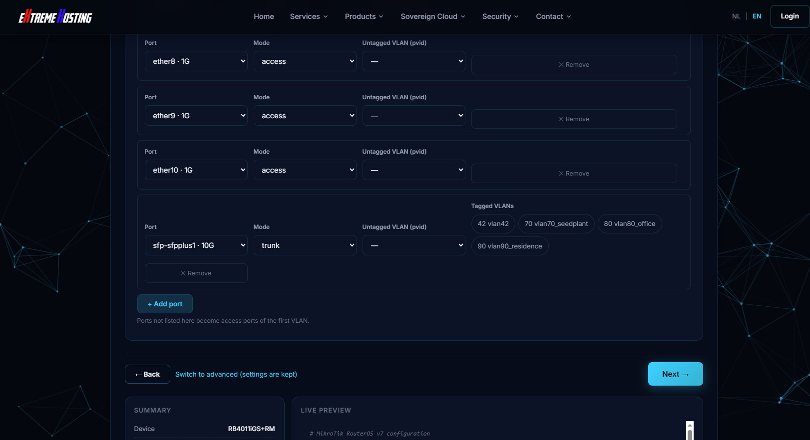

I just tried it out. Couldn't add another reply, so appending it here.
Just testing out the config generator.
These were inputs
And the generated config:
Generated RB4011 Office with Vlan config
