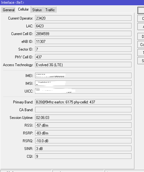

I’m finding the signal very erratic also. the unit is looking straight at the mast. NO trees or buildings. Around 3 miles away. Current speed test 3.2mbps!
There appears to be NO CA Band.
Please help!

CellMapper is a site with location of BTS/eNB and what Sector Antenna are installed with what Band and BandWidth … at your ISP 3 UK I see only that one in your region. More info or more LTE Tower have got EE and winner is Vodafone UK but I haven’t idea what you have in real world.
You should do a cell-monitor and thy it in differ world site’s to determine your area.
See the signal of your current CellID:
primary-band: B20@5Mhz earfcn: 6175 phy-cellid: 388
This B20 is one of slowest (compare to B3 > B1 > B7 who are THREE KING’s of LTE in EMEA and R11e-LTE6 only do 2CA: B3+B7 between them).
At http://anisimoff.org/eng/lte_throughput_calculator.html is this info about max your speed when you are near to BTS…:
And you have got your:
rsrp: -81dBm
rsrq: -13.5dB
sinr: 7dB
cqi: 10
Who are not the best and not the worst… but your cell are connecting with only @5Mhz and not @20Mhz :frowning: and without additional ca-band.
When I try search other ISP and other BTS then I see all with B20@5Mhz or B20@10Mhz :(… and one exception with Vodafone:

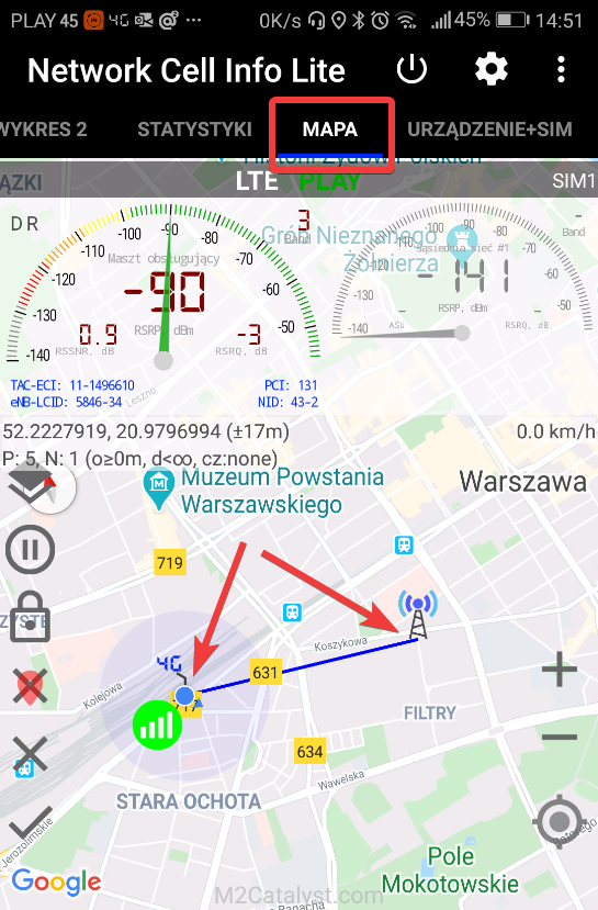

This means you should install Mobile APP who give information whith one BTS you are connected, on what Band and BandWidth etc.. because I haven’t that information online and CellMapper is not proper as you can see via my limitation.
Android: Network Cell Info Lite > Data tab.

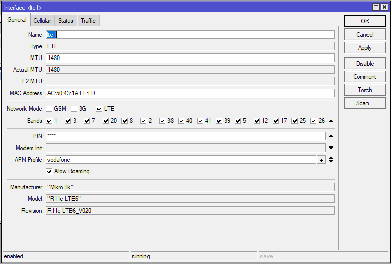

At MikroTik you can do a Cell-Monitor to scan what your MikroTik see in air. Remember to not set CellLock and specific band because your RB see only this band or cell.
Do:
# Disable CellLock - AutoSellect Cell
interface lte at-chat lte1 input="AT*Cell=0"
# Select 3g and LTE
interface lte set lte1 network-mode=3g,lte
# Select All Band-s means no one specific to enable
interface lte set lte1 !band
# SCAN YOUR AIR and search good band! Slow to Speed are: B8/B20/B3/B1/B7. SXTR is 60° and LHGR is 30° and move device and scan again until you do 360°.
interface lte cell-monitor lte1
Now you see your ISP only. Not work in roaming because show still your original BTS only.

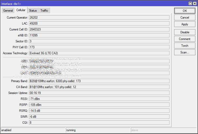

Man I thought I was the only one. I am having all of the same problem. ALL OF THE SAME.
1- Erratic signal. From full strength to 1 bar… It’s all over the place and I am barely over a mile away.
2- No matter what SIM I use NOR what carrier, it will not do anything other than “Evolved 3G” even though putting the SIM into a phone results in 4G LTE right away.
All but 2 bands are not supported. So I KNOW it should at least be connecting to those bands at 4g LTE. I have yet to find anybody with an answer. How did you solve the issue?

I have similar situation using r11e-LTE6 with only 2 band accessible and one is slow with good signal and second fast with low signal and the modem itself one time prefer a and sometimes prefer opposite one. All this in 4G-LTE Cat.6 who give us 2xBand connection.
The primary-band only show signals on LED’s.
I fix this by 2 ways:
  • select only band who give me speed with low signal - that way I use modem as Cat.4 device only with one active band
  • use Cell-Lock to specific Band/CellID to force exact Band as primary-band and that way my preffered band is used and signals at LED give me the always the same results. Of course the second ca-band is used automatically. In my situation device can stuck in offline and I use own checking and fixing script.

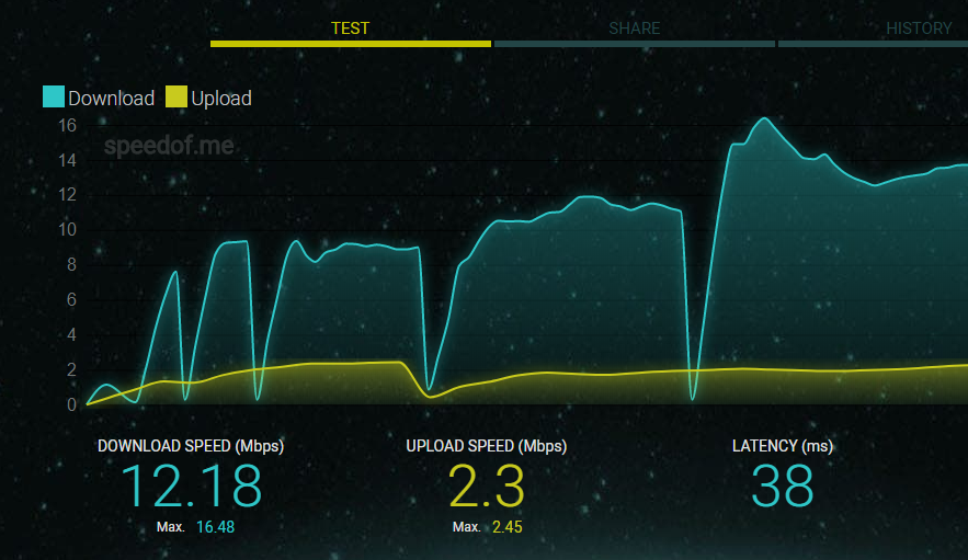

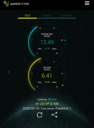

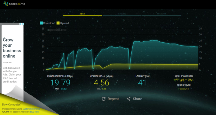

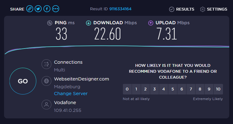

Just tested new delivered RBLtAP-2HnD&R11e-LTE6 … and so far I’m seeing similiar performance as with my huawei-pad.
No reason to get lost in frenetic jubilation, but since my old teltonika maxed-out at 5 MBit/s download speed … I’m o.k. so far.
Guess I have to repeat tests later at night, when the horny folks chilled down and traffic is low.
But again … whats wrong with B20 ?
