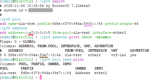

Here you can see it working fine:
Here a7 is the subnet-id (8 available bits with a /56 prefix) that you can hardcode in the address entry. With a /60 pool then of course you can only choose 4 bits.

Does it work also if prefix falls into "upper part" of the /56 ? E.g. not fd5e:6379:994a:0000::/56 but fd5e:6379:994a:5900::/56 ? It used to work for the former case already in ROS v6 ... but not for the later case. The problem was that ROS took the prefix from pool as a whole (including the 00 from part 5900 which is not part of /56 prefix) and the "subnet id" as well ... and couldn't combine them intelligently (i.e. to 59a7). With "bottom part" (all zeroes) it successfully formed e.g. 00a7 ...
When rrported, they claimed it wasn't bug report but rather feature request ... so I wonder if they finally came around to do/fix it.
It seems to work:
And the ability to have the preferred subnet-id is really new in 7.21. With <= 7.20.4 attempts like above resulted in this:
