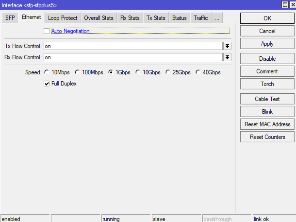

Are you seeing the 2.5Gbps speed option on the SFP+ port when you disable auto negotiation?
I upgraded the CRS309 to 7.3beta37, and 2.5Gbps option isn’t available.
