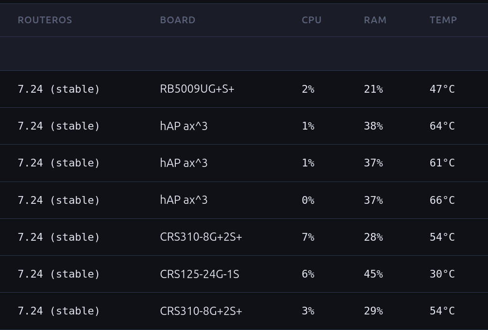

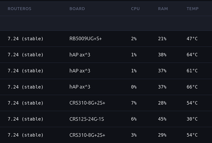

Compare with:

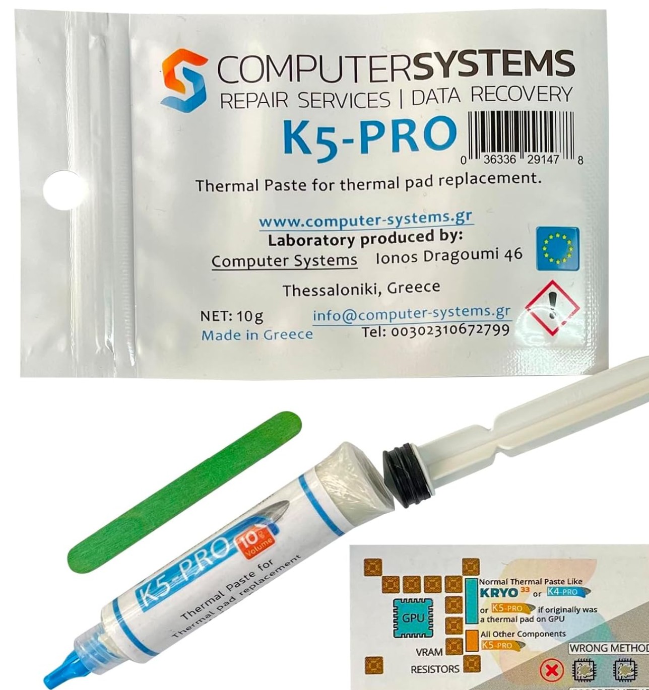

With two active Wireguard tunnels, the temperature reaches 85°C :scream:
I'll try replacing the thermal pads with this paste.
Thanks!

@massinia
A word of advice:
thermal paste=thermal paste
thermal pad=thermal pad
They are not interchamgeable.
In some cases thermal pads can be replaced with thermal silicone putty (which Is not thermal paste), see:
AX S Manufacturing Issue? - #18 by jaclaz
