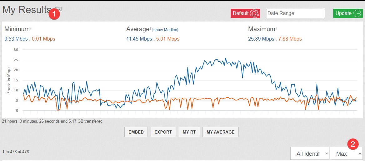

Sometimes I use a testmy.net with phone/laptop who will a graph of 1d of speedtest’s.
Old example:
Never heard of that site. Going to check them out. Thanks.
