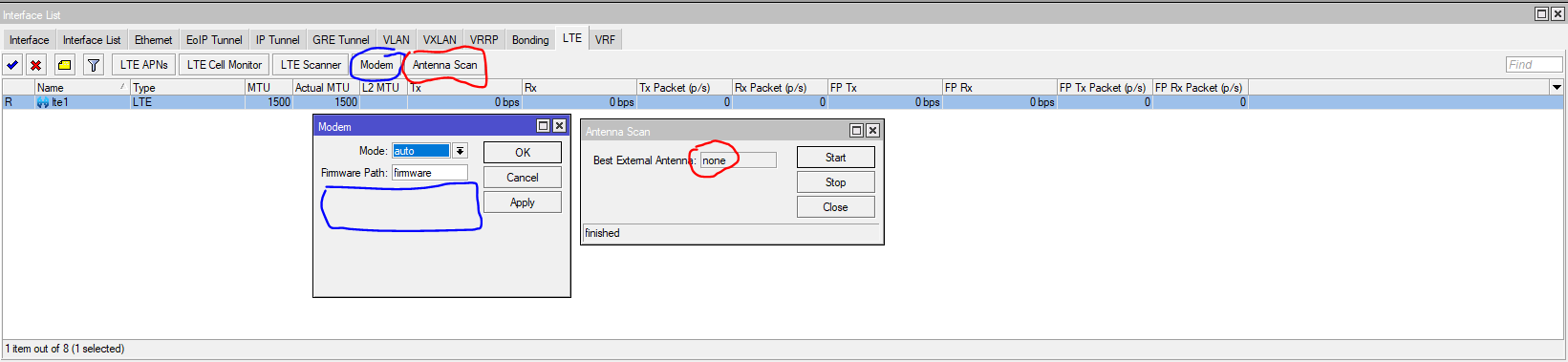

I work for an Operator Company and we use Mikrotik Chateau LTE12 for 4G network. I meant to put external antennas on this Mikrotik to increase the throughput, but unfortunatly, i found a problem. My external antenna are not detected by the mikrotik even through they are great linked. The external antenna is a mANT LTE 5o.
Antenna to chateau
ANT1 to ANT1
ANT2 to ANT4
In Interface > LTE > Antenna Scan → none
Furthermore, while looking through a solutions on forums and manuels, an option is not on my RouterOS which is on others in the forums. In Interface > LTE > Modem > External Antenna () ||
It mean i can’t select any external Antenna. I’ve tried with an other fresh new Mikrotik and mANT LTE 5o.
Can you help find a solution ?
In the attachment, i upload a picture of my RouterOS screenshot and a picture of my Router Chateau.
Thanks !

Are you able to switch to the external antennas with the CLI command?
/interface/lte/settings/set external-antenna=both

Yes, it work with the CLI commands. And with a print :
/interface/lte/settings/print
mode: auto
firmware-path: firmware
external-antenna: both
But when i scan Antenna it still doesnt find the Antenna and the button in the graphic is still not shown.
