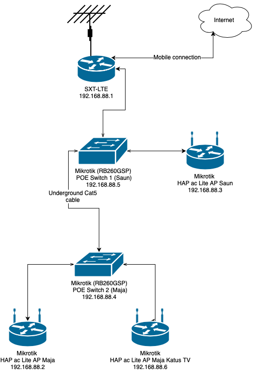

Also i have attached the network topology:
Every AC lite box runs 2.4GHz on different channels to make sure they don’t overlap.
Can anyone please tell me what am i doing wrong. I have been searching for a solution for months now and still got problems. This however is the most stable setup i could get. Default configuration with minor tweaks, as putting the router in bridge mode and assigning static ip address, will not work at all.

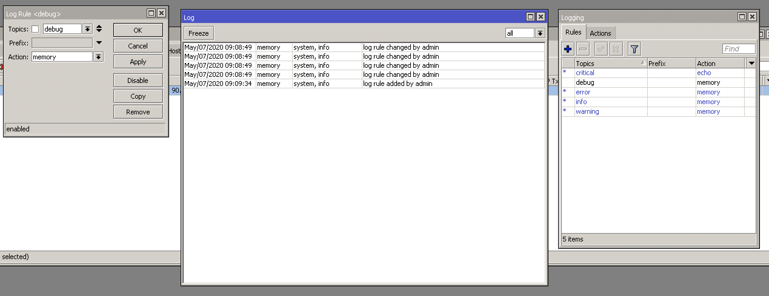

I have all the logs enabled even debug but the log is empty? Is there a guide how to turn it on?

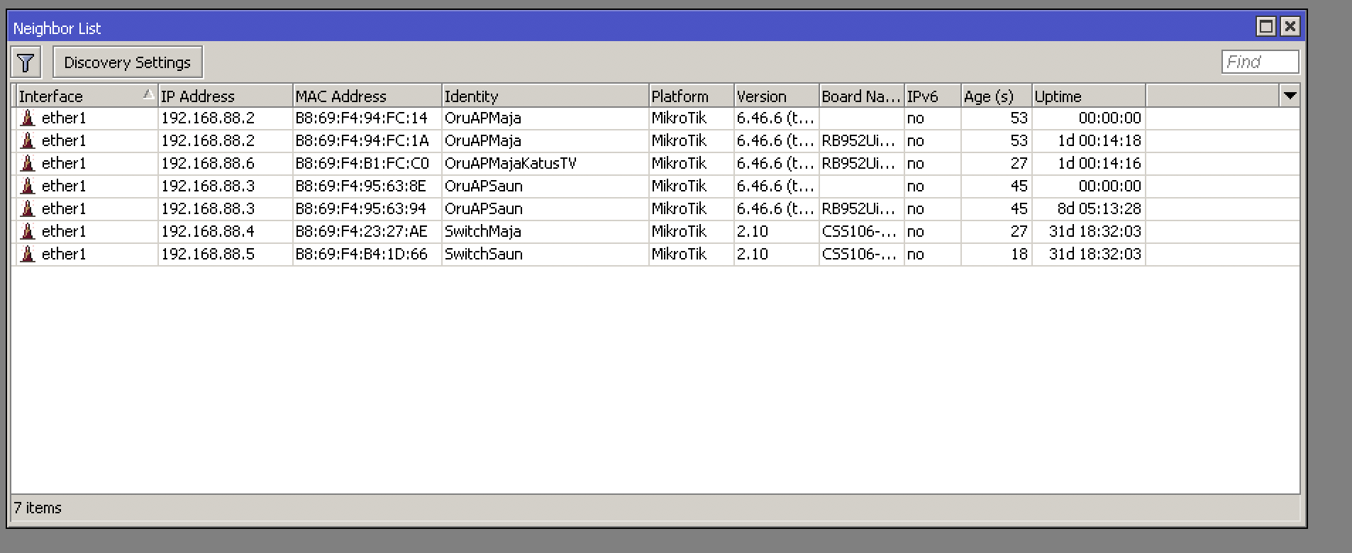

Also one thing i noticed, maybe it’s ok maybe not but when i look at the SXT-LTE neighbours list i see 2 mac addresses from 1 device.
Although on that AP on eth1 and wlan1 i have ARP disabled.

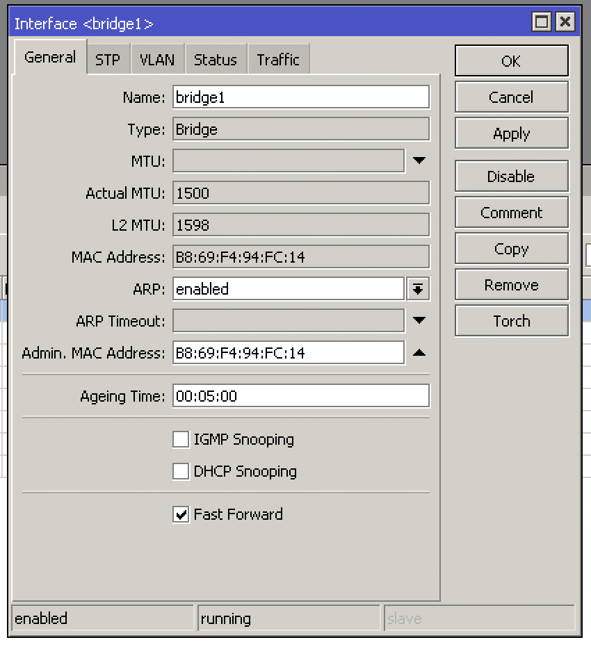

Okay that mac address problem seemed to do the trick.. had to set the admin mac address on the bridge..
The admin mac address on the bridge is set to eth1 which is my “WAN” port that is connected to the switch.
Also got my logging working as well.

Like i said it is a layer 2 problem. It has nothing to do with CellLock or anything of the sorts. SXT-LTE works fine. The problem is with the internal network and when i setup the AP i added interfaces to the bridge as follows:
add bridge=bridge1 interface=ether2
add bridge=bridge1 interface=ether3
add bridge=bridge1 interface=ether4
add bridge=bridge1 interface=wlan2
add bridge=bridge1 interface=wlan1
thus auto-mac feature on the bridge interface took wlan1 mac aadress for it’s own mac address as well.
it should have been like this..
Or better yet the bridge should have it’s own mac address that is unique to the network.
john231
True
my all bridge interface have got uniq admin mac-address.
I generate MAC address by adding new EoIP interface who generate mac-address itself - I not add EoIP, just open form of new tunnel to copy from it new mac-address and press Cancel.
One question still.. Now when i have all my interfaces in a bridge and bridge has been assigned an ip and ip neighbor discovery is set as default " !dynamic ".
When i look at discovered neighbours i see the bridge mac and eth1 mac of all the AP’s shouldn’t i only see the bridge one?
/ip neighbor print
 # INTERFACE ADDRESS                                 MAC-ADDRESS
 0 ether1    192.168.88.1                            B8:69:F4:01:35:55
   bridge1
 1 ether1    192.168.88.2                            02:2A:F3:AA:A1:E2
   bridge1
 2 ether1    192.168.88.2                            B8:69:F4:B1:FC:C0
   bridge1
 3 ether1    192.168.88.3                            02:2F:19:EF:AF:37
   bridge1
 4 ether1    192.168.88.3                            B8:69:F4:95:63:8E
   bridge1
 5 ether1    192.168.88.4                            B8:69:F4:23:27:AE
   bridge1
 6 ether1    192.168.88.5                            B8:69:F4:B4:1D:66
   bridge1
What is the neighbour discovery used for?
This is normal because this discavery is at Layer2 and show real interface, even if he is assign to bridge… look
