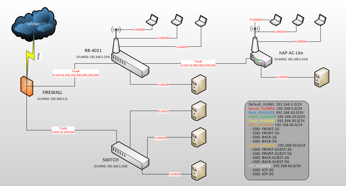

My current setup has a pfSense Firewall connected to Fibre Internet. I have 3 physical locations that I need to provide connectivity to; Front House, Cabin and Back House, all connected via CAT5E Ethernet. I have a MikroTik hAP-ac-lite in the Front House, a Netgear WNR3500L in the Cabin and an Asus RT-AC3200 in the Back House all connected through the Firewall to the Internet.
Internet > Firewall > 192.168.1.0/24 = Back House Network devices including Cabin Netgear WNR3500L
Firewall > hAP-ac-lite > 192.168.2.0/24 = Front House devices
There are about 40 devices on this network ranging from end user devices (PC’s, Tablets, Laptops, Phones, etc) to smart devices (Chromecasts, Home automation controllers, Game Consoles, etc) to Servers (NAS, Web, Email, etc) to Network devices (Switches, Routers, Firewalls) which all have varying security profiles (Untrusted, Trusted, Insecure, Guest, Secure, etc) and require differing management and access controls.
Below is an image of where I would like to get to in terms of network isolation:
My initial configuration has got the trunk between the Firewall to the RB-4011 configured and serving the Cabin_VLAN200 and another trunk between the Firewall to a NetGear ProSafe switch serving the Server_VLAN50 and Back_VLAN100. Layer 3 Routing and DHCP is being provided by the Firewall and working correctly for these VLANs.
I am having problems understanding the correct (or most correct) way to achieve the above. I have read differing statements on forums, in documentation and in practice things are not really making sense to me. Most of the time I configure anything further on the RB-4011 or hAP AC Lite I lock myself out of the device (although interestingly traffic still flows just fine) and have to reset it to defaults and start over. I have zero problems with either the Firewall or the Netgear Switch. I can even get VLANs running on the Asus RT-AC3200 (I am wanting to discontinue this device), but there is something I am not understanding with the MikroTik configurations.

What do you mean by “tagging the bridge”? Frames can be tagged and untagged, bridges cannot.
The bridge forwards a frame with any VLAN ID that makes it to it; you can configure which VLANs are allowed on which port and whether frames belonging to these VLANs should be tagged on ingress & untagged on egress through that port or left intact.
Please have a look at this post and tell me whether it has helped.
So the Orange firewall does all the Routing and DHCP service and the RB4011 is just a VLAN bridge type entity (switch)?? Seems like a waste but oh well.
  1. Your Bridge port wlan-5G needs a PVID, as devices attached are not vlan smart. (add pvid=500)
  2. Remove reference to vlan in wireless settings!! “vlan-id=400”, this identification is carried out in bridge port settings and bridge vlan settings.
  3. Remove reference to vlan in wireless settings!! “vlan-id=500”, this identification is carried out in bridge port settings and bridge vlan settings (once you fix the above)

Your best reference is, understanding Sindy’s diagram and then reading this

Notes: what i cannot remember is why the Bridge does not have to be tagged for the wlans, and possible Eth3, need mkx or Sindy intervention to explain!!
wlan interface is historically capable of dealing with VLANs itself. If wlan interface has vlan-id=400 vlan-mode=use-tag (set in /interface wireless section), then from bridge point of view this is tagged port and should be added as tagged member to appropriate VLAN.
If, OTOH, one uses wlan interface as untagged (i.e. with no vlan-related settings on wlan interface), then everything should be set in /interface bridge subtree: it should be added to bridge with PVID setting and should be added as untagged member of corresponding VLAN (which is actually done automagically but can be done explicitly anyway).
hAP ac lite should have PVID set on ether3 as it is (most probably) access port and connected PC is probably unaware of VLANs. This is probably true for all other ether ports (sans ether1 which is trunk towards RB4011).
You missed the question entirely LOL.
I was asking to confirm why or why not the Bridge needs to be tagged or just the incoming port on the hapac (ether1) for the vlans that are not management and not trunked elsewhere on the hapac (basic vlan into and untagged out on some port).
I still fail to understand your question. Which bridge personality (according to classification by @sindy) are you talking about?
Im talking about the bridge personality on the hapac.
Why is it that the wlan ports which are tagged for ether1 and untagged for wlan port DO NOT NEED the bridge to be also tagged.
In comparison the managment VLAN
needs to be tagged with ether1 AND the bridge!!
In other words explain what is needed for ether3, which is tagged with ether1 and untagged for vlanXXX as required, Does the bridge also need to be tagged and if not for the same reason as the WLAN?
@anav, with your mileage in ROS and VLANs I still don’t get what exactly is bothering you. I’ll try to answer never the less (but I’ll probably miss the point).
Bridge personality of bridge … just carries frames between ports … doesn’t care if they’re tagged or not.
When you’re talking of bridge being tagged, then it’s the “the router-facing port of the virtual switch” (nomenclature by @sindy) personality you’re probably referring to. And settings to that personality only affects communication between device’s L3 (IP stack) and the rest of LAN. If device is not used for routing between different IP subnets and LAN features dedicated VLAN for management, then device’s bridge (“the router-facing port of the virtual switch” part) only needs to be member of management VLAN. It can either be tagged or untagged, however I’m all for tagged which means bridge will be tagged member of said VLAN and will feature vlan interface (anchored off bridge) with matching vlan-id set. The rest of VLANs, passing between bridge ports, are (and should be) ignored by bridge “the router-facing port of the virtual switch” and thus this “the router-facing port of the virtual switch” is neither tagged nor untagged member of other VLANs.
One should always think about which port should participate in which VLANs and if it should be tagged or untagged. The same goes for bridge “the router-facing port of the virtual switch”.
Thank you gentlemen for your advice and wisdom. I am definitely further along with your help and can report that I now have things looking much more like my diagram (which I have also updated so the big orange box is a much smaller orange box) :wink:
I have moved the House hAP-AC-Lite to Eth10 and configured my old Asus RT-AC3200 in its place for the meantime as there were comments made at dinner time about the amount of downtime… I feel like I am almost there, a bit more testing to be done. I have plans to add firewalling and RADIUS authentication for the Secure_Wifi, but for now I very much appreciate your assistance with my understanding and have put my current configs below:

If its working for you, great!
If not would need an updated diagram to match.
Yes is working (as far I can tell), but I need to test the SSIDs to ensure they are correctly assigning the VLAN IDs. Other than that I will need to enable VLAN filtering (ingress / egress) and confirm that devices connected to the hAP-AC-Lite get the correct VLAN ID (IP configuration) which will have to wait until the morning.
