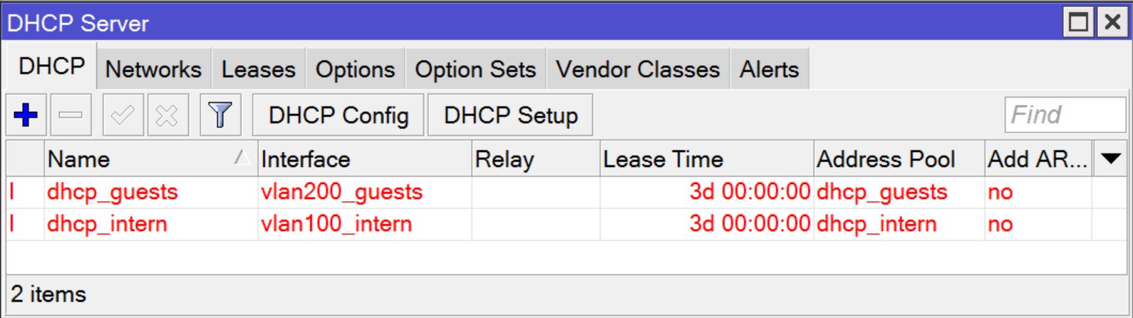

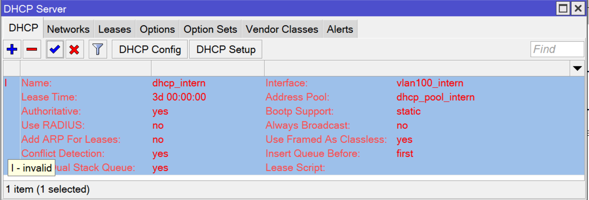

Guten Abend ,
Your DHCP-Servers are not configured properly.
Deactivate the DHCP-Relay “Feature” and everything will work again!
add address-pool=dhcp_intern disabled=no interface=vlan100_intern lease-time=3d name=dhcp_intern relay=192.168.1.1
add address-pool=dhcp_guests disabled=no interface=vlan200_guests lease-time=3d name=dhcp_guests relay=192.168.2.1
Ebenfalls einen guten Abend!

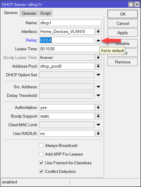

Thank you very much for the advice. I have now set the address of the relay to 0.0.0.0 (switched off, according to the doc). Unfortunately, Winbox says that the DHCP server configuration is invalid, I do not know why. Previously the configuration was once valid.
Press the “Up-Arrow” to deactivate
Thanks, I also tried this, also invalid configuration according to Winbox. Also adding the DHCP server again and setting it up manually (without DHCP Setup Wizard) gives the same result.

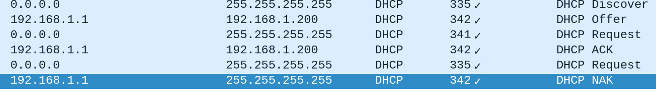

Unfortunately, I still do not get an IP address, so I started wireshark. There is probably a DHCP server active, but the address assignment fails (NAK). I still need to understand why. Ff you are interested: https://apackets.com/api/v1/pcaps/public/download/d1ddf089ce6a39af2ed56cbce6b66370.pcapng/dhcp.pcapng.
https://apackets.com/pcaps?pcap=d1ddf089ce6a39af2ed56cbce6b66370.pcapng&view=devices
For some reason the DHCP-client of my laptop (ubuntu) was requesting an IP-address from previous configuration (192.168.88.1) after finished DHCP negotiation. I solved this renewing the clients DHCP IP address with the command “sudo dhclient”. Now I get correct IP-addresses in both LANs (intern/guest) and I am able to ping the router only in intern LAN.

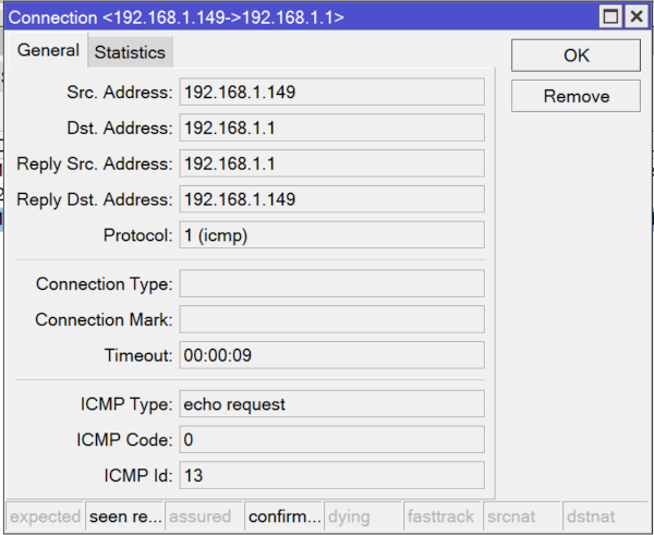

Today I wanted to prepare the configuration so far that the router can be connected to the Internet. Here I have oriented myself to the following article (most suggestions I have taken over, but not all).
https://help.mikrotik.com/docs/display/ROS/First+Time+Configuration
The internet connection from the router works, I can ping in with name resolution from the router. Unfortunately, I cannot ping the router itself from either ether1_internal or ether2_guests. The IP configuration and route on the client is set correctly. In the connections tab of the firewall the connection is also shown, yet I get at the client: ping: sendmsg: Netzwork is unreachable.

Thanks for the tips, I have adopted the configuration accordingly. Unfortunately, I still can not reach the router via IP address (e.g. via Winbox IP/ ICMP Ping). WinBox Mac on the other hand works. In the firewall of the router the connection is still shown. I suspect a problem with the vlan configuration or the firewall, but have not been able to find it yet. Attached is the current configuration from also the terminal output from the client to ether2_internal. Any ideas?
add admin-mac=2C:C8:1B:B1:3A:82 auto-mac=no comment=defconf name=bridge \
    vlan-filtering=yes
set [ find default-name=ether1 ] name=ether1_WAN
set [ find default-name=ether2 ] name=ether2_intern
set [ find default-name=ether3 ] name=ether3_guests
set [ find default-name=ether4 ] name=ether4_AP
/interface vlan
add interface=ether1_WAN name=vlan10_netcologne_data vlan-id=10
add interface=ether1_WAN name=vlan20_netcologne_voip vlan-id=20
add interface=bridge name=vlan100_intern vlan-id=100
add interface=bridge name=vlan200_guests vlan-id=200
/interface pppoe-client
add add-default-route=yes disabled=no interface=vlan10_netcologne_data name=\
    PPPoE_Out use-peer-dns=yes user=nc-myusername@autoprov.netcologne.de
set 0 default-vlan-id=0
set 1 default-vlan-id=0
set 2 default-vlan-id=0
set 3 default-vlan-id=0
set 4 default-vlan-id=0
set 5 default-vlan-id=0
set 6 default-vlan-id=0
set 7 default-vlan-id=0
set 8 default-vlan-id=0
set 9 default-vlan-id=0
set 10 default-vlan-id=0
set 11 default-vlan-id=0
add comment=defconf name=WAN
add comment=defconf name=LAN
add name=dhcp_intern ranges=192.168.1.100-192.168.1.200
add name=dhcp_guests ranges=192.168.2.100-192.168.2.200
add address-pool=dhcp_intern disabled=no interface=vlan100_intern lease-time=\
    3d name=dhcp_intern
add address-pool=dhcp_guests disabled=no interface=vlan200_guests lease-time=\
    3d name=dhcp_guests
add bridge=bridge comment=defconf interface=ether2_intern pvid=100
add bridge=bridge comment=defconf interface=ether3_guests pvid=200
add bridge=bridge comment=defconf interface=ether4_AP
add bridge=bridge comment=defconf interface=ether6
add bridge=bridge comment=defconf interface=ether7
add bridge=bridge comment=defconf interface=ether8
add bridge=bridge comment=defconf interface=ether9
add bridge=bridge comment=defconf interface=ether10
add bridge=bridge comment=defconf interface=sfp-sfpplus1
/interface bridge vlan
add bridge=bridge tagged=bridge,sfp-sfpplus1,ether4_AP untagged=ether2_intern \
    vlan-ids=100
add bridge=bridge tagged=bridge,sfp-sfpplus1,ether4_AP untagged=ether3_guests \
    vlan-ids=200
add comment=defconf interface=ether1_WAN list=WAN
add interface=vlan100_intern list=LAN
add interface=vlan200_guests list=LAN
add interface=bridge list=LAN
add address=192.168.1.1 interface=vlan100_intern network=192.168.1.0
add address=192.168.2.1 interface=vlan200_guests network=192.168.2.0
/ip cloud
set update-time=no
add address=192.168.1.0/24 dns-server=192.168.1.1 domain=lan gateway=\
    192.168.1.1 ntp-server=192.168.1.1
add address=192.168.2.0/24 dns-server=192.168.2.1 domain=guests gateway=\
    192.168.2.1 ntp-server=192.168.2.1
set allow-remote-requests=yes
add action=accept chain=input comment="accept established,related" \
add action=drop chain=input connection-state=invalid
add action=accept chain=input comment="allow ICMP" in-interface=ether1_WAN \
    protocol=icmp
add action=drop chain=input comment="block everything else" in-interface=\
    ether1_WAN
add action=fasttrack-connection chain=forward comment=\
    "fast-track for established,related" connection-state=established,related
add action=accept chain=forward comment="accept established,related" \
    "drop access to clients behind NAT form WAN" connection-nat-state=!dstnat \
    connection-state=new in-interface=ether1_WAN
add action=masquerade chain=srcnat out-interface=ether1_WAN
/ip service
set telnet disabled=yes
set ftp disabled=yes
set www disabled=yes
set ssh port=2200
set api disabled=yes
set winbox address=192.168.1.0/24
/ip ssh
set strong-crypto=yes
/system clock
/tool bandwidth-server
set enabled=no
/tool mac-server
/tool mac-server mac-winbox
client:~$ ifconfig enp0s31f6
enp0s31f6: flags=4163<UP,BROADCAST,RUNNING,MULTICAST>  mtu 1500
        inet 192.168.1.148  netmask 255.255.255.0  broadcast 192.168.1.255
        inet6 fe80::cc8b:d84b:12e8:fe0f  prefixlen 64  scopeid 0x20<link>
        ether e8:6a:64:e7:ad:77  txqueuelen 1000  (Ethernet)
        RX packets 288070  bytes 279155714 (279.1 MB)
        RX errors 0  dropped 0  overruns 0  frame 0
        TX packets 227385  bytes 19457310 (19.4 MB)
        TX errors 0  dropped 0 overruns 0  carrier 0  collisions 0
        device interrupt 16  memory 0xec200000-ec220000
client:~$ route
Kernel-IP-Routentabelle
Ziel            Router          Genmask         Flags Metric Ref    Use Iface
default         _gateway        0.0.0.0         UG    20100  0        0 enp0s31f6
link-local      0.0.0.0         255.255.0.0     U     1000   0        0 enp0s31f6
192.168.1.0     0.0.0.0         255.255.255.0   U     100    0        0 enp0s31f6
client:~$ ping 192.168.1.1
PING 192.168.1.1 (192.168.1.1) 56(84) Bytes Daten.
^Z
[3]+  Angehalten              ping 192.168.1.1
